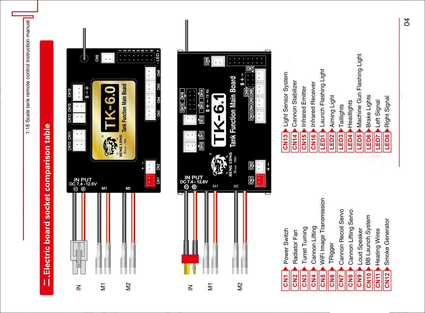

Re: Heng long tk6.0 vs tk6.0s
tk 6.0 smoker blow with piston ,6.0S blow with modified fan
tk 6.0 cn 11 feed 7.4 v cn 12 feed 3-5 v (proportional)
tk 6.0S cn 11 feed 6 v cn 12 feed 6 v fix
Why Heng Long do this? I think 6.0 when tank don't run ,smoke will flood to the ground.
Makes sense. The voltage for the smoker circuit must be lower on the “S” as Tinsen indicated, òr keeps the fan running at a slightly higher RPM at idle, because connecting the new, fan-based smoker to a “non-S” will give sùch an abundance of smoke, that it edges on the ridiculous. It smokes like mad on idle. Closer to a battlefield smoking system than an exhaust.
The only time I saw thìs much smoke from a HL smoker was when I drove the resistor in the reservoir with a volt-up to 9v ( that... didn’t survive for very long... )
I also got a T72 with the new smoker and a 6.0-S in it, and that most certainly doesn’t make the crazy amount of smoke the non “S” makes..
When driving, it calms down though, and looks rather good, even in windy conditions, I’d have to say..
It’s going to be interesting to see how long the new resistor wire will stay alive on the non-S controllers I run.
Another nice detail of the TK 6.1s : It has a metal casing! I was wondering how they would keep the high-amp drive MosFets cool.. well.. there was my answer. 25000rpm amp-chugging RS390 motors are now a reliable option for more modern tanks. No more worries something will let-out the Holy Smoke if running those in heavy terrain.
My Leopard 2a6 came with the v6.0S. Would replacing it with a v6.1s give any problems?
Hi LeoLeo Part 1 wrote:My Leopard 2a6 came with the v6.0S. Would replacing it with a v6.1s give any problems?
It's almost a 1: 1 conversion. All you have to do is change the battery plug (not MFU) to T-Deans (female). This will protect you in the future against the risk of short-circuiting or swapping + / - wires. And it will allow for lower losses (resistance) in the flow of current.
