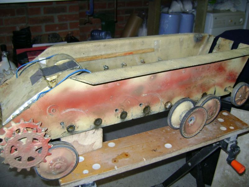

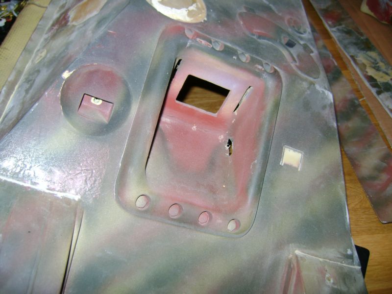

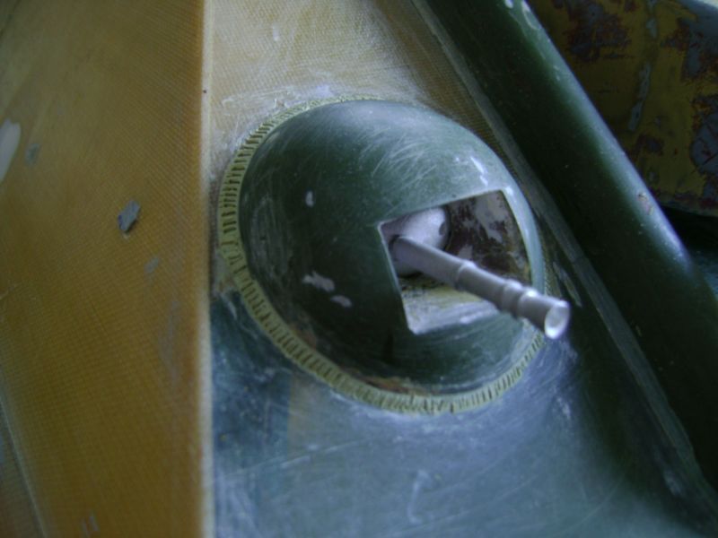

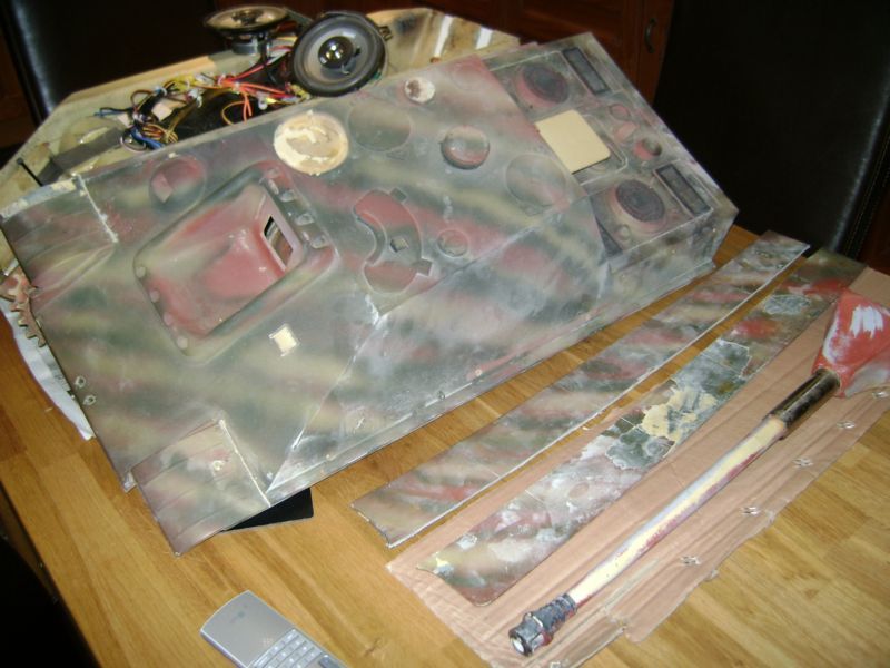

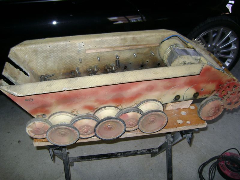

Hi, new to the forum, tanks and rc modelling. Recently acquired an old mark-1-tank 1/8 jagdpanther in need of some cosmetic repair, paint job and detailing. "won't take long" I convinced myself. The more I researched the more I realised needed to be done. On closer inspection it became clear there were other issues other than cosmetic condition/lack of detail. Nearly all the suspension arms were seized solid in there bushes which would not respond to intensive wd40,pliers and heat treatment, they would have to be cut out. The barrel had been snapped and bodged up, which now blocked it up. This was a pain as Iwanted to line the open barrel so it could fire elecric initiated pyros. Probably in the same accident a large crack inthe mantlet had appeared. There were also some scale inaccuracies inherrent from manufacture, some could be changed, others I'd have to live with. I decided to get to work. It was going to have smoke capability, new flammvernichter exhausts, schurzen were coming off (which meant re-constructing the sides of the hull), muzzle loaded pyro firing capability and extensive detailing as far as my limited skill will allow. Enough to be getting on with. Work started a few months back and I've taken a few snaps along the way.
Bit of a state, angle grinder has already fetched of shurzen

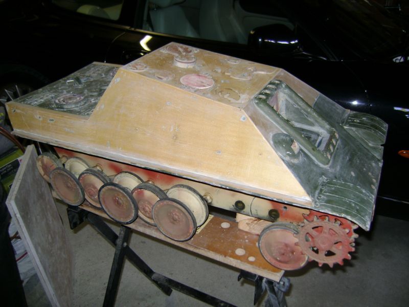

Post surgery. With shurzen off you can see where the sides of the upper hull need to be re-constructed. note paint falling off.

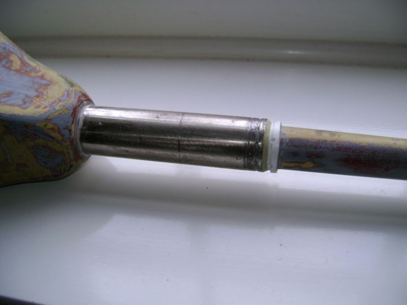

you can see the barrel is now opened up and lined with copper tube. Had to re-break the barrel to do it. Stainless tube hides repair and with further detailing will become the later 2-piece barrel.

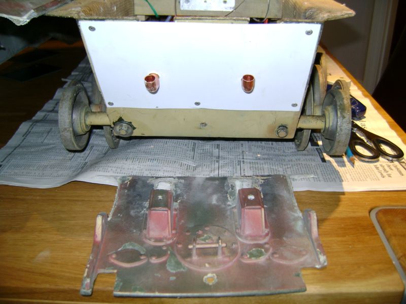

angle grinder also removed back plate from upper hull. this will saved and be fixed to lower hull.

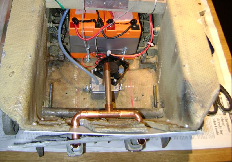

new smoker and start of plumbing.

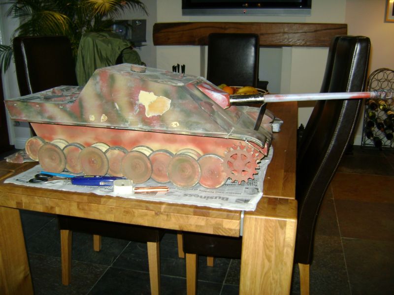

mmm nice paint. note accident damage inside mantlet area.

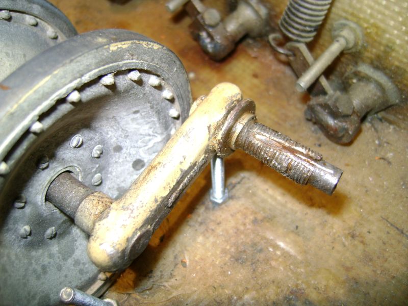

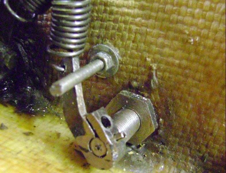

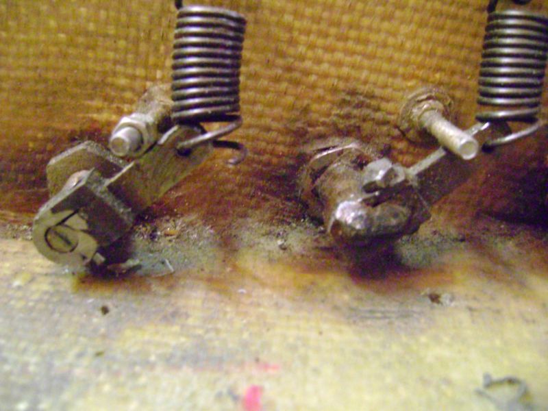

Here's a few more photos. Work stopped on the hull for quite a while I tried to sort replacement bushes which were to be cut off the suspension arms. The inner arms which connect the suspension arm axle to the spring are all welded on. this meant stripping the whole thing right down to get the angle grinder in to grind of the welds. This was easier said than done. I decided a different method to welding when re-installing. I went for spring pins which work great and can be drifted out relatively easier if the bushes need freeing/replacing in the future. The problem was drilling the holes to accept these pins. Acheiving the correct alignment and tension on the springs in situ whilst drilling was a pain to say the least.

underside view
underside view

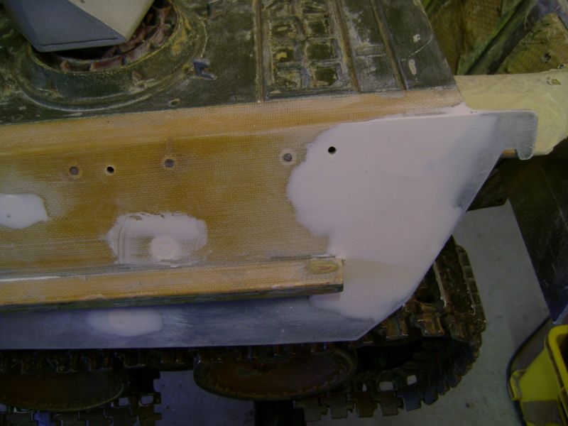

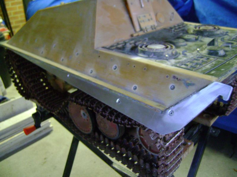

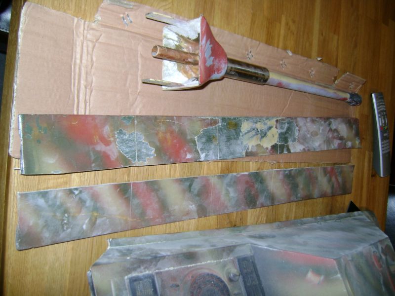

after cutting cardboard templates,converted into 4mm duralumin, then riveted in place with countersunk pop rivets

arm on left refitted with spring pin, on the right the original weld method
....and the other side
one out, all out!
one out, all out!

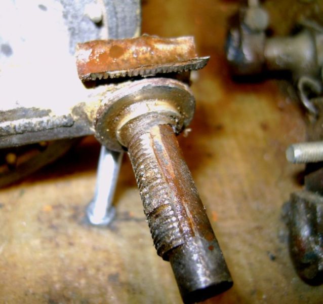

no wonder they werent turning!
with the arm removed from the chasis Icould cut off the rust seized bushes

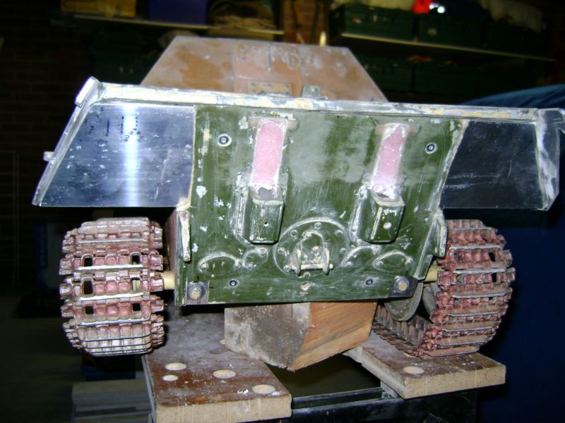

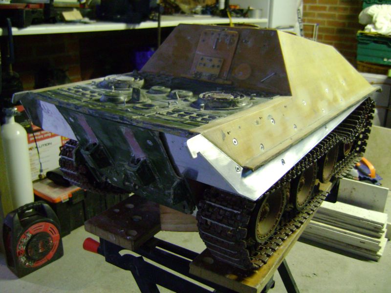

Afew steps more.
top and bottom finally fiftting together after a bit of tweaking, time for some storage bins
after cutting off the old exhausts and filling the holes the original back plate is riveted into position. This would now allow removal of the upper hull without disturbing the exhaust and smoke system, unlike the original design

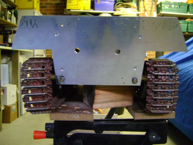

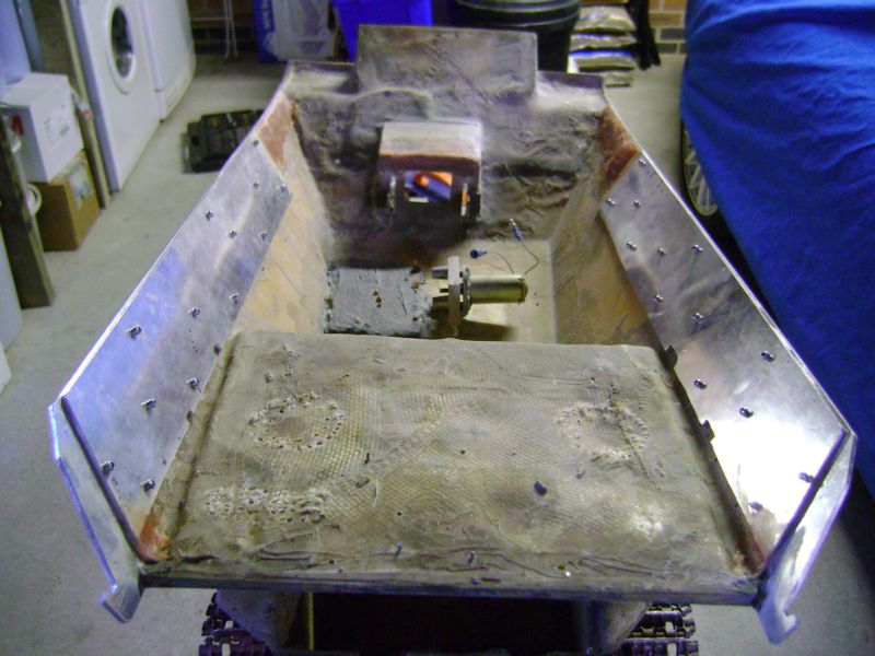

after much trial and error with templates the new back plate is riveted on

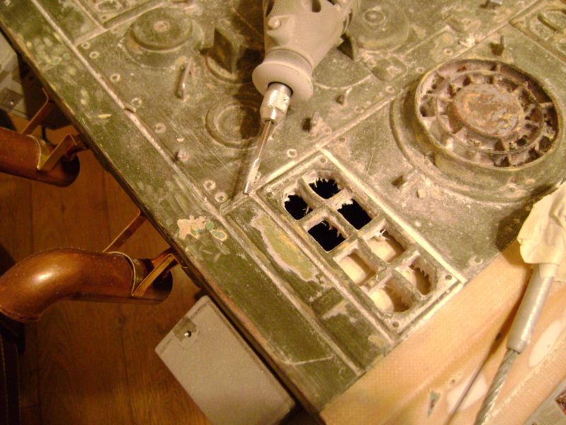

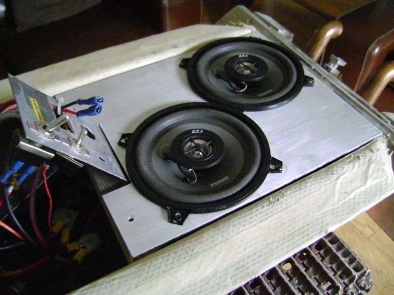

ally plate to hold new speakers. Hopefully the newly opened up vents in the hull will let some of the sound out!

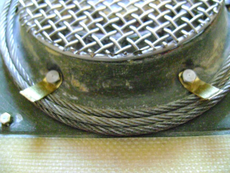

close up of cable lugs

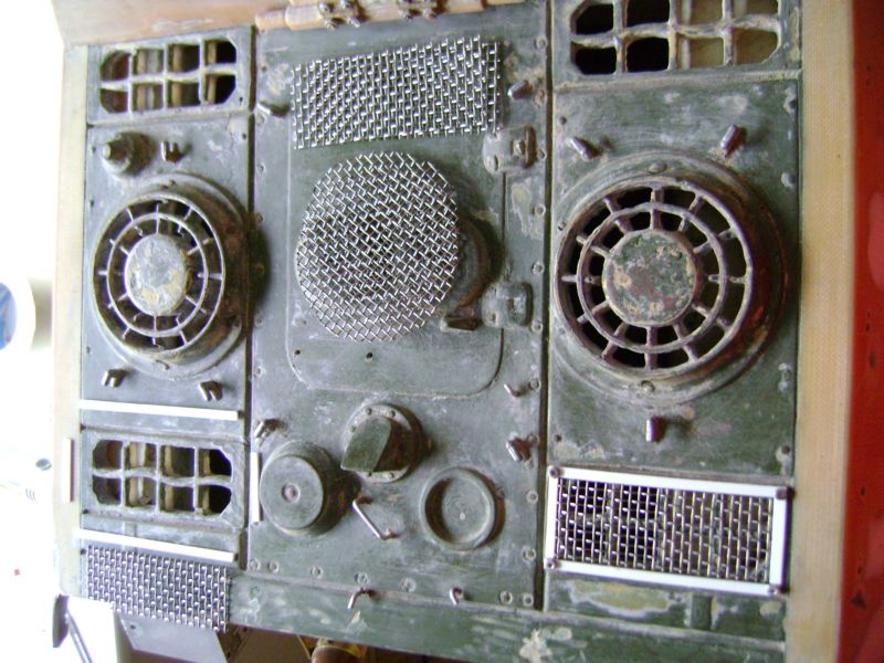

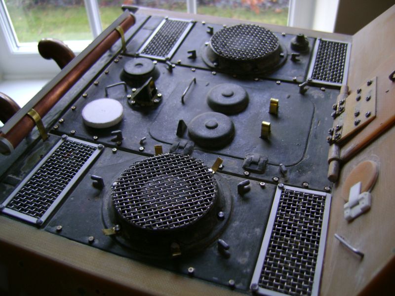

The rear deck after its first round of detailing. Ba nuts used after removing moulded "lumps". The barrel cleaning tube is a prototype and not the right size yet.

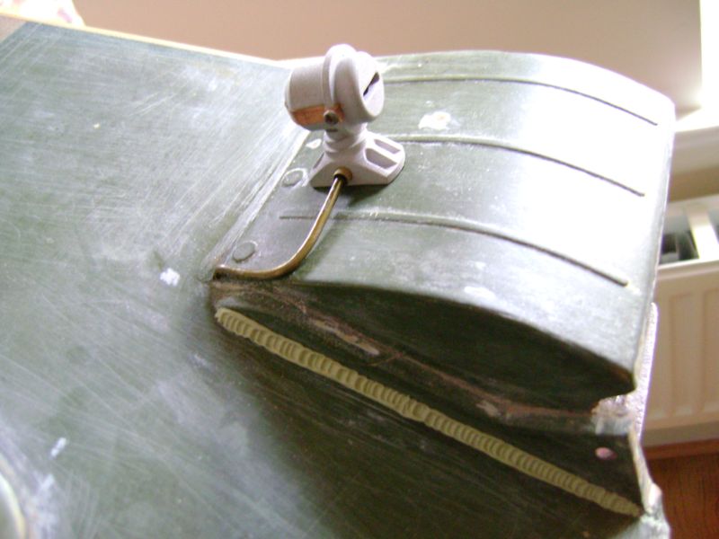

new headlight fitted and a bit of weld detail

many hours of dremel action to open up the vents.

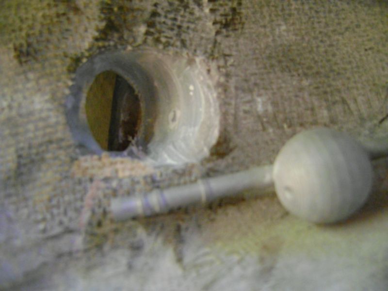

cut out for new mg and ball

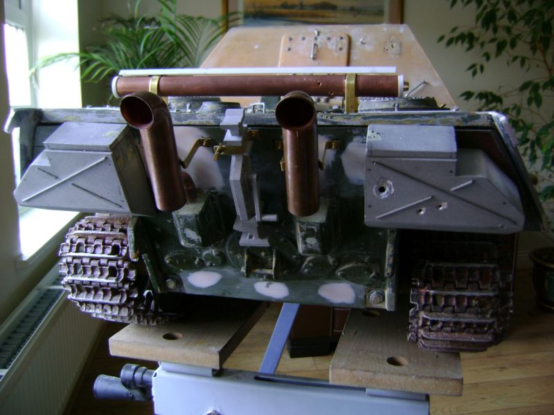

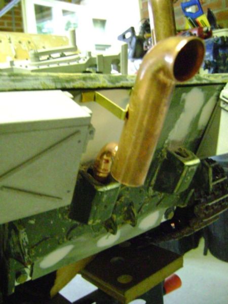

New exhausts getting plumbed in. storage bins going on but will get some rework to there lids and hinges. New jack waiting to go on.

Rear so far, still loads to do.
rear so far. More detail to go on yet, bins to be modified. A new barrel cleaning tube is on the way.
