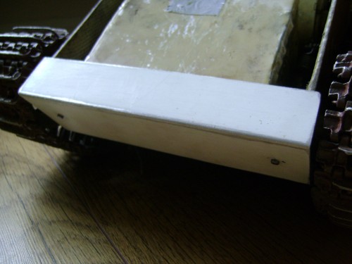

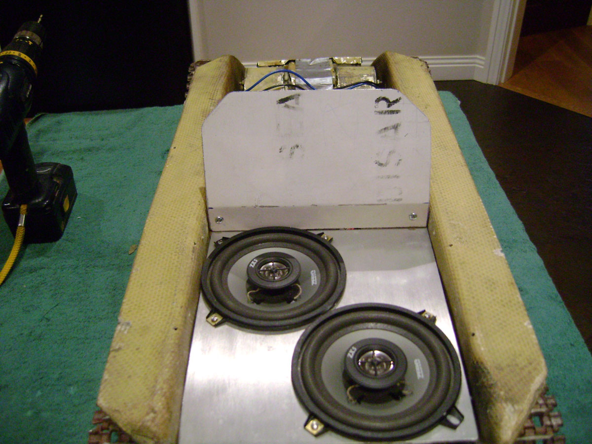

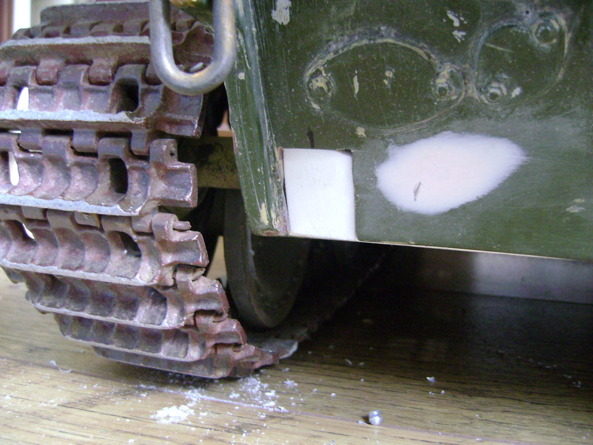

"bash" plate added to protect front of lower hull and will also be part of upper hull attachment

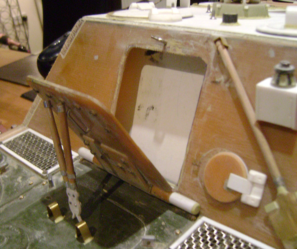

crew hatch re-hinged to open more like the real thing. Opening enlarge to give etter access to new control panel

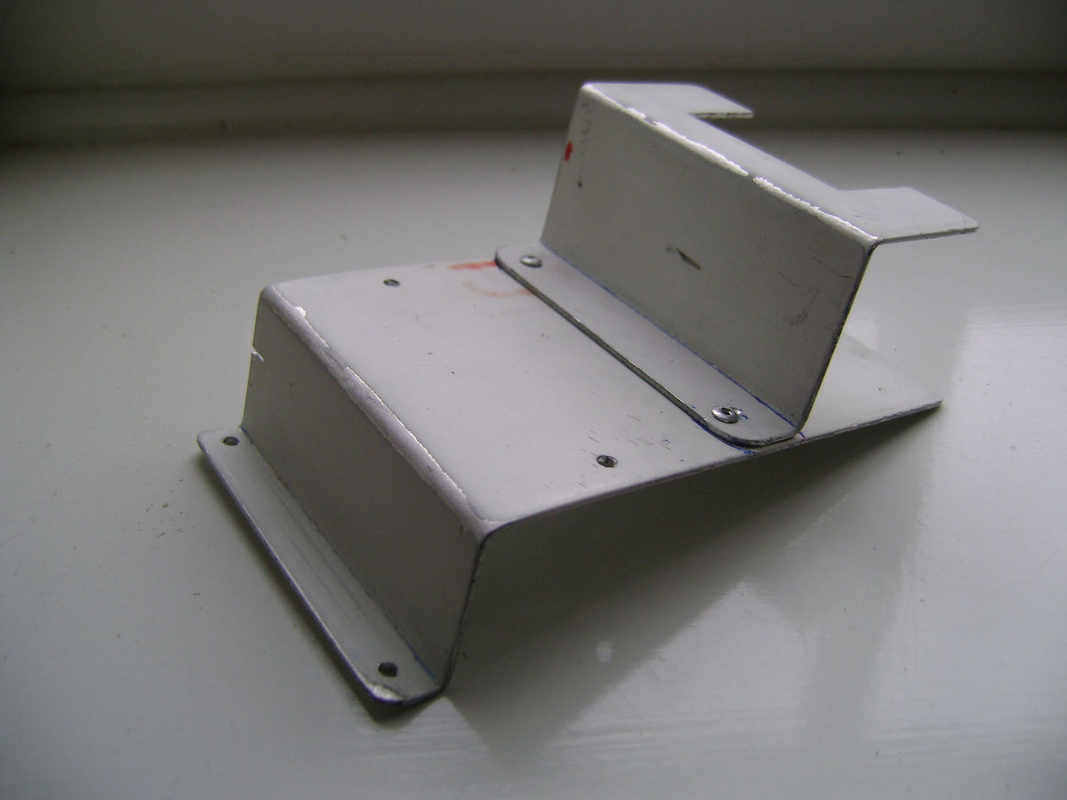

speaker plate lowered and the beginings of a control panel which will be acessed by the crew hatch

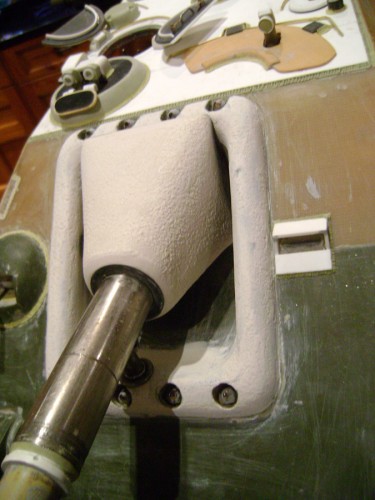

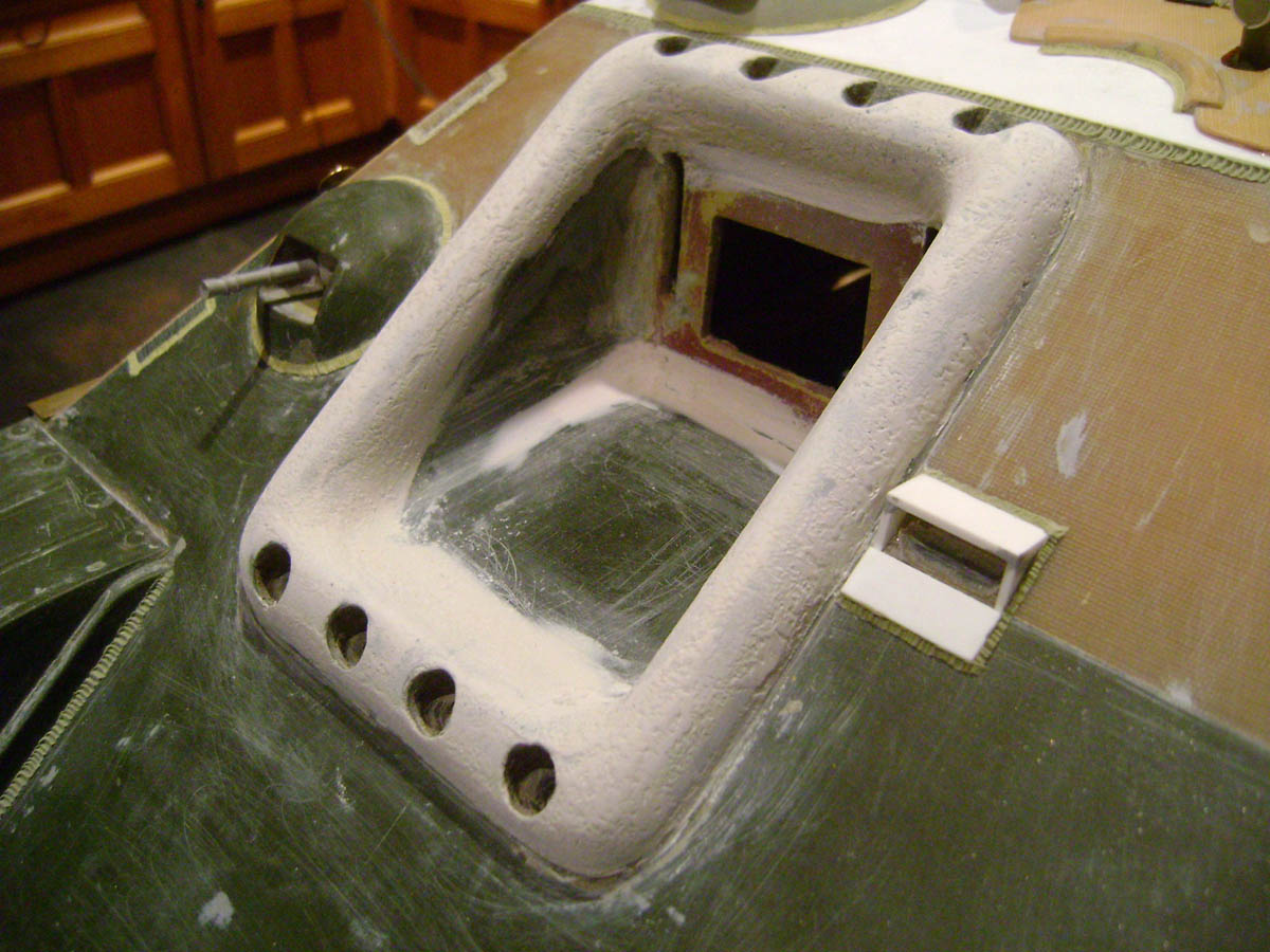

texture added around mantlet area by stippling fine car body filler and then sanding it back.

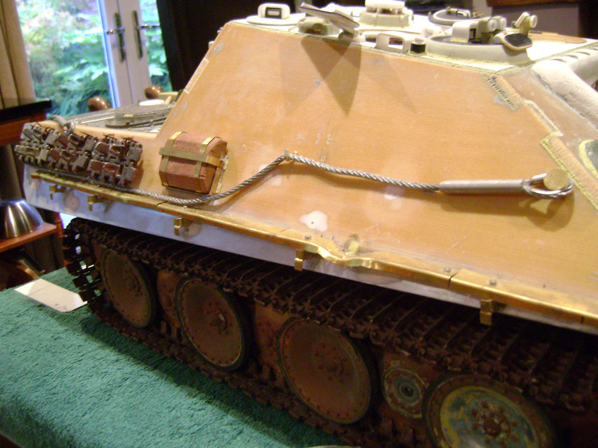

Finally got the other tow cable fitted and formed/kinked to sit correctly

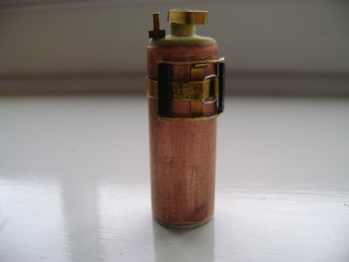

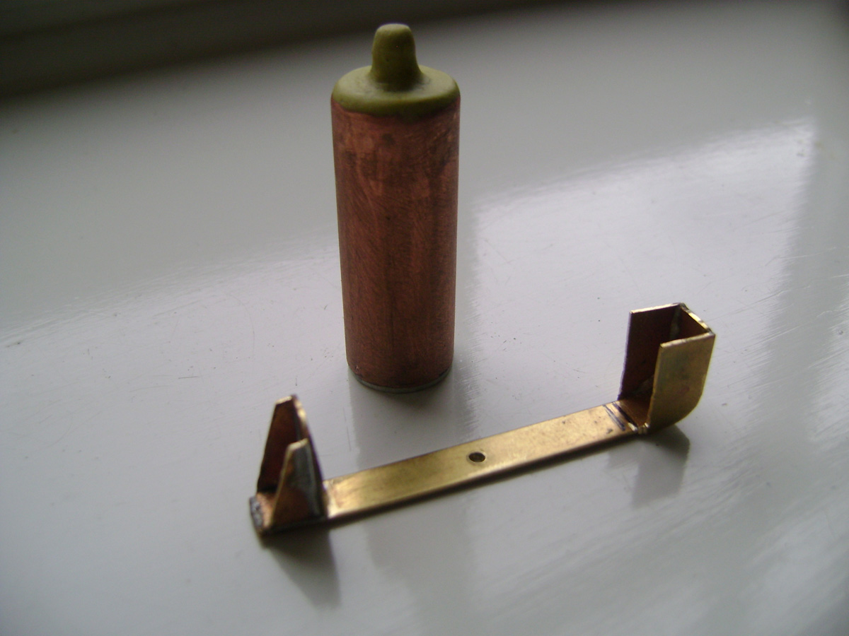

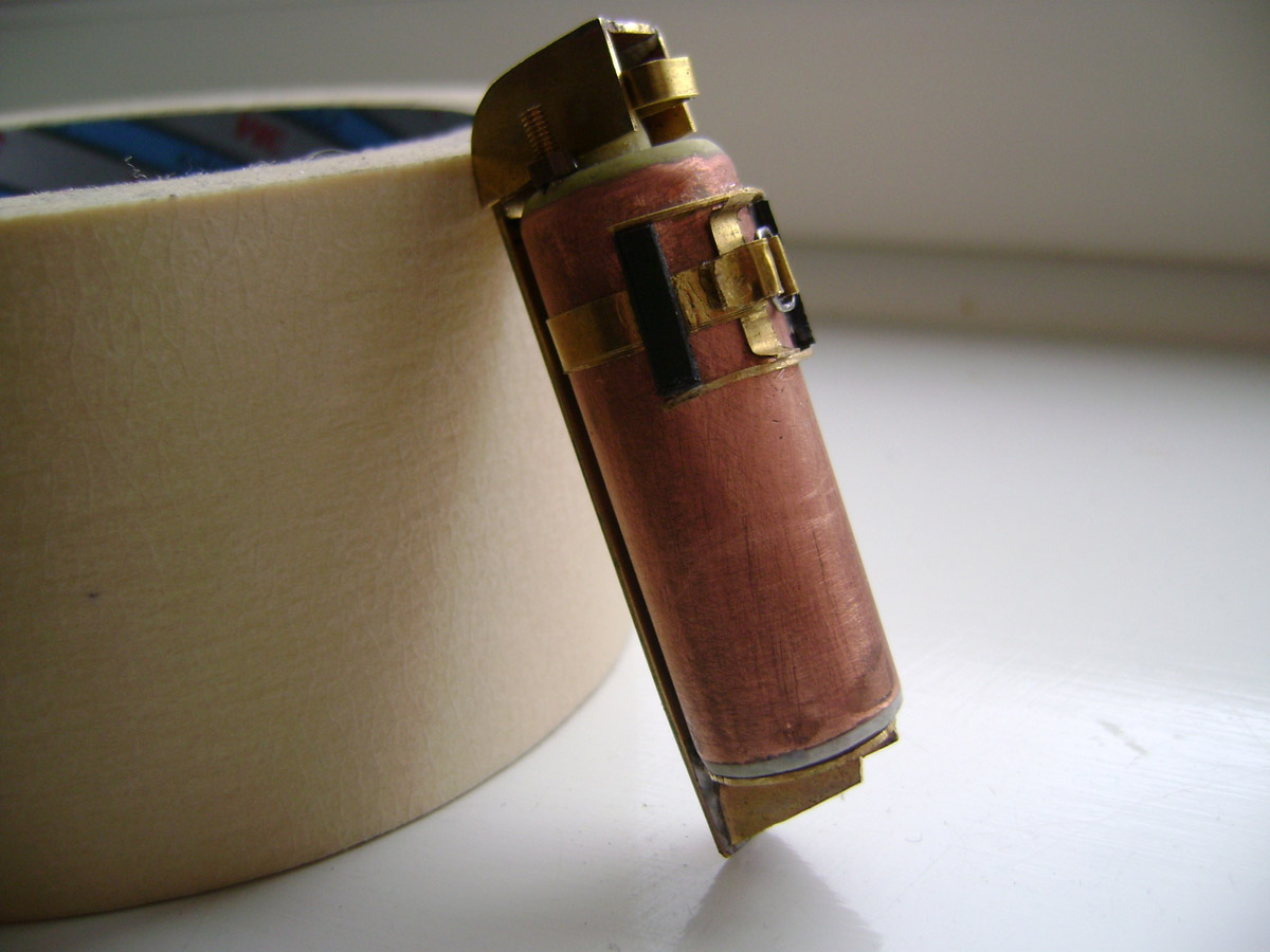

Today has been fashioning a tetra fire extinguisher out of brass and a bit of copper pipe.
will have to try and freehand the tetra makings when it comes to paint.
milliput used to shape top of cylinder.

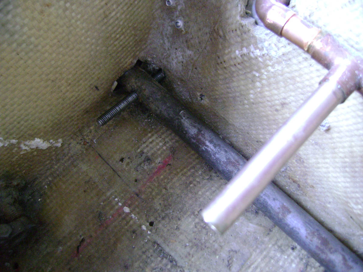

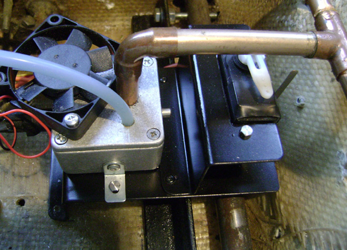

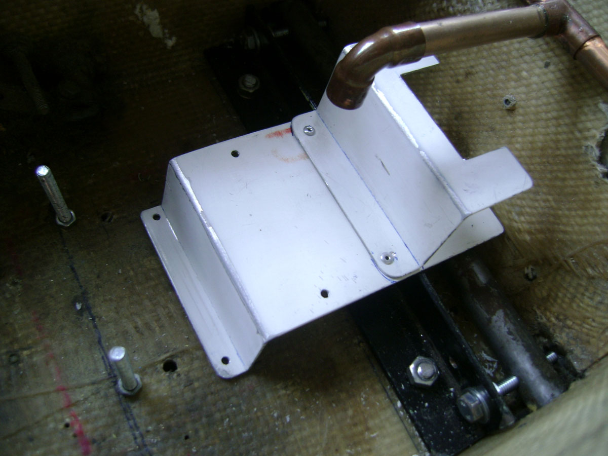

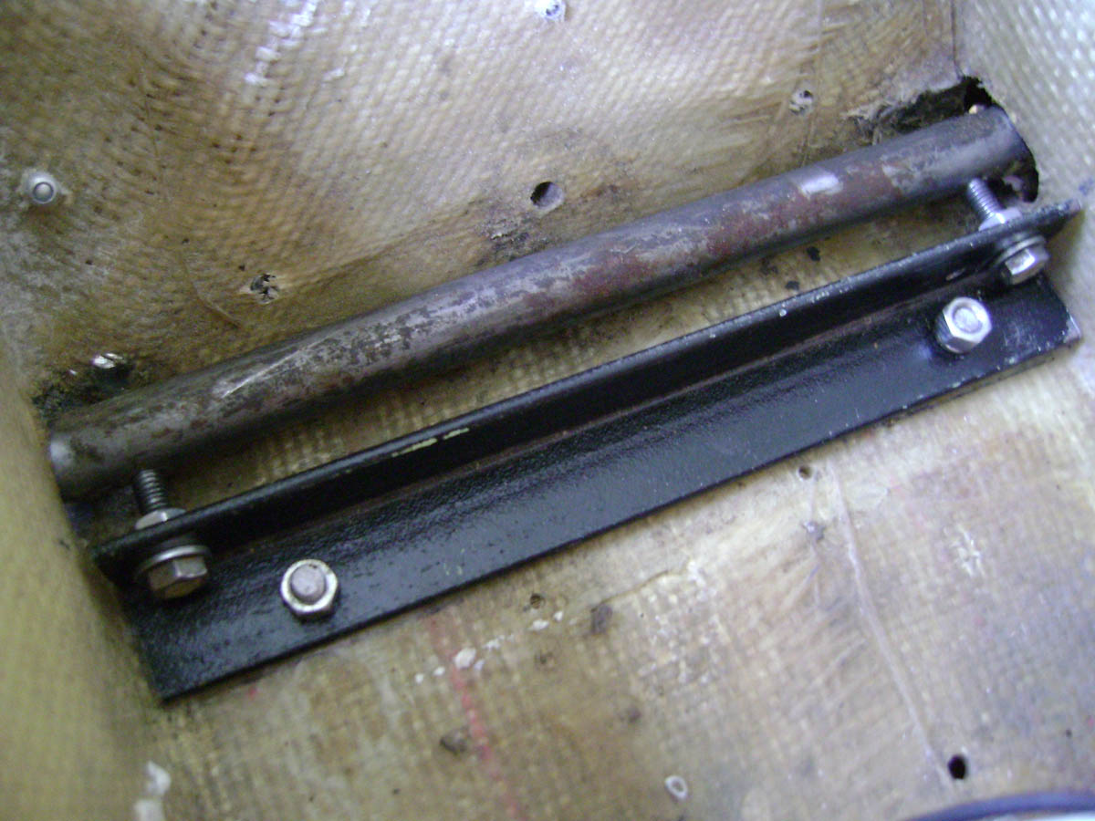

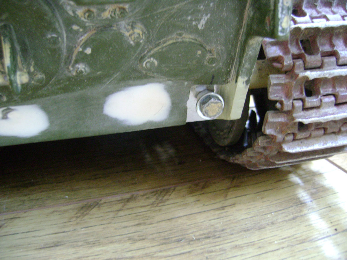

I took a break from detailing and decided to sort out the track tensioning. I went for an internal solution as I wasnt keen on the original external approach.
Finally installed with smoker, servo and microswitch
The new bracket in situ.
Whilst I had the smoke unit out to do the tensioner I thought I'd make a bracket to hold the smoker and its operating servo and microswitch all together.
Hole blocked ready for tidying up. I will be moving on to the detailing of the rear next so it was good to get this bit out of the way.
The new internal track tensioner. Should be more robust.
...and outside. The large hex head bolt showing wasnt great.
This shows the original tensioning set up inside

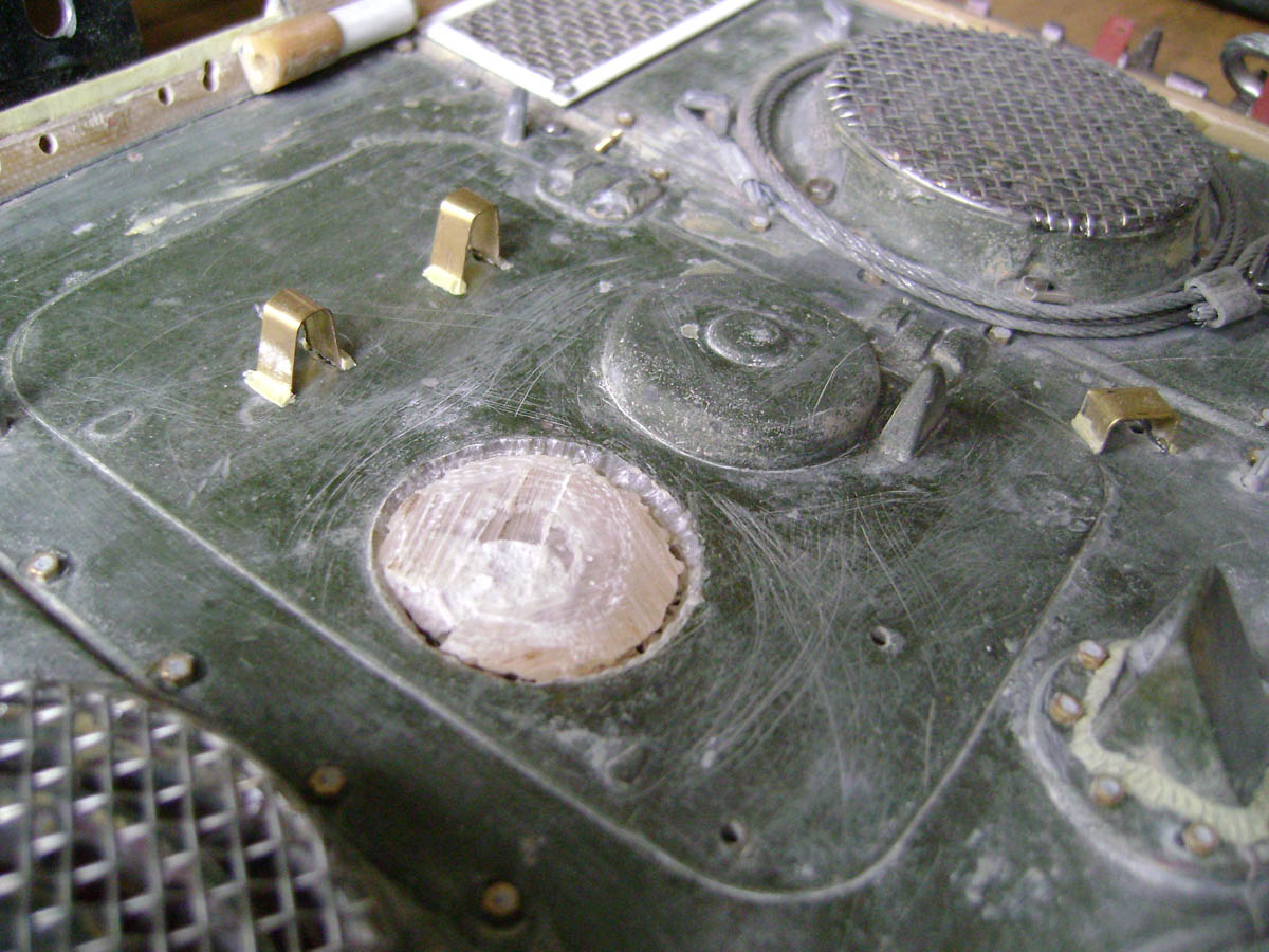

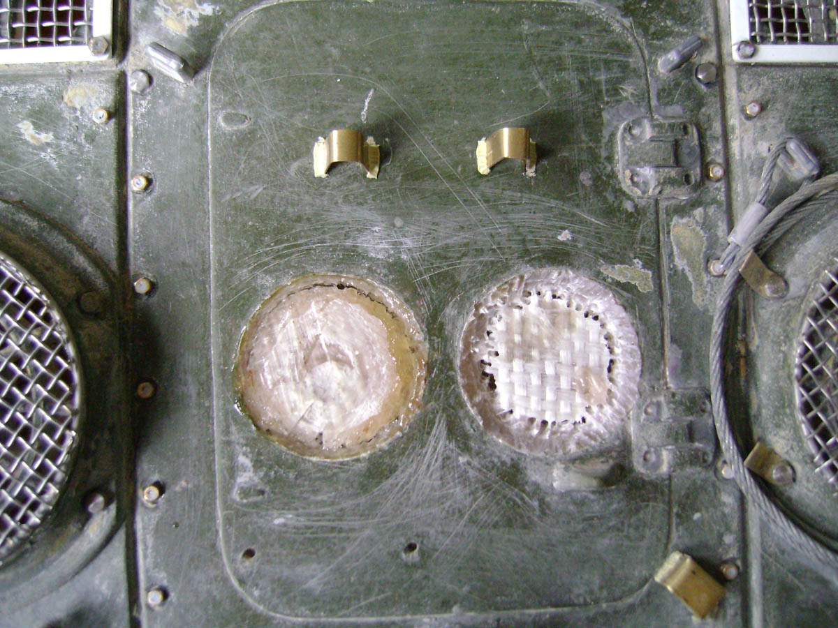

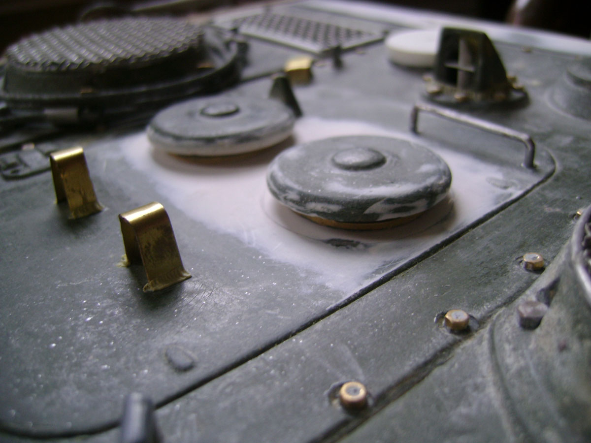

I decided to remove some of the "moulded on" detailing on the engine hatch. I should of done this earlier on as it would have been a lot easier trying not to disturb bits and pieces I'd already done.
a pain to do but look miles better. There are tiny brass "rain" strips underneath them.

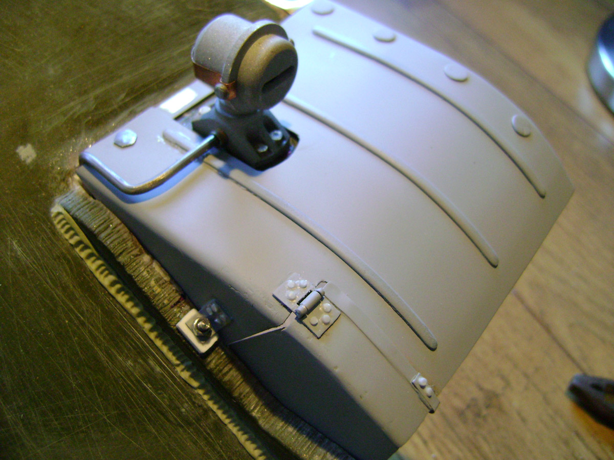

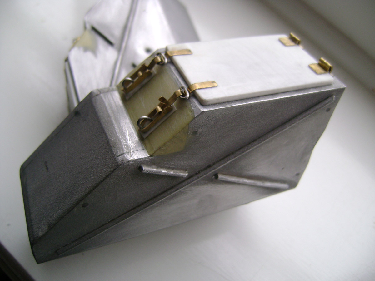

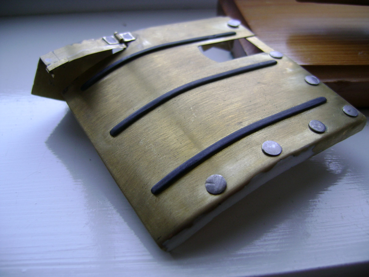

Storage bin modifications. A bit of re-shaping, new lids and catches. Looks better than my first attempt.

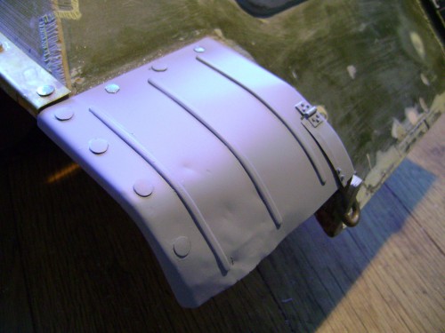

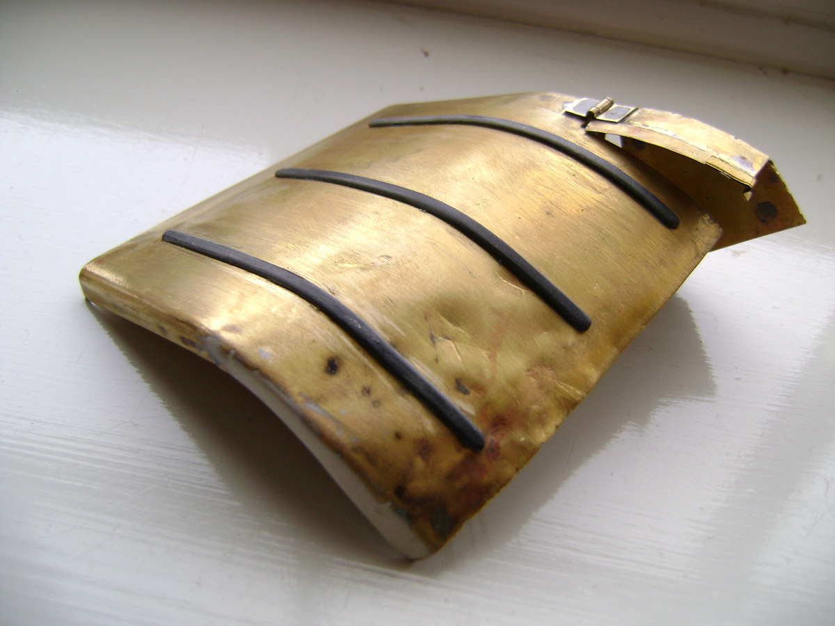

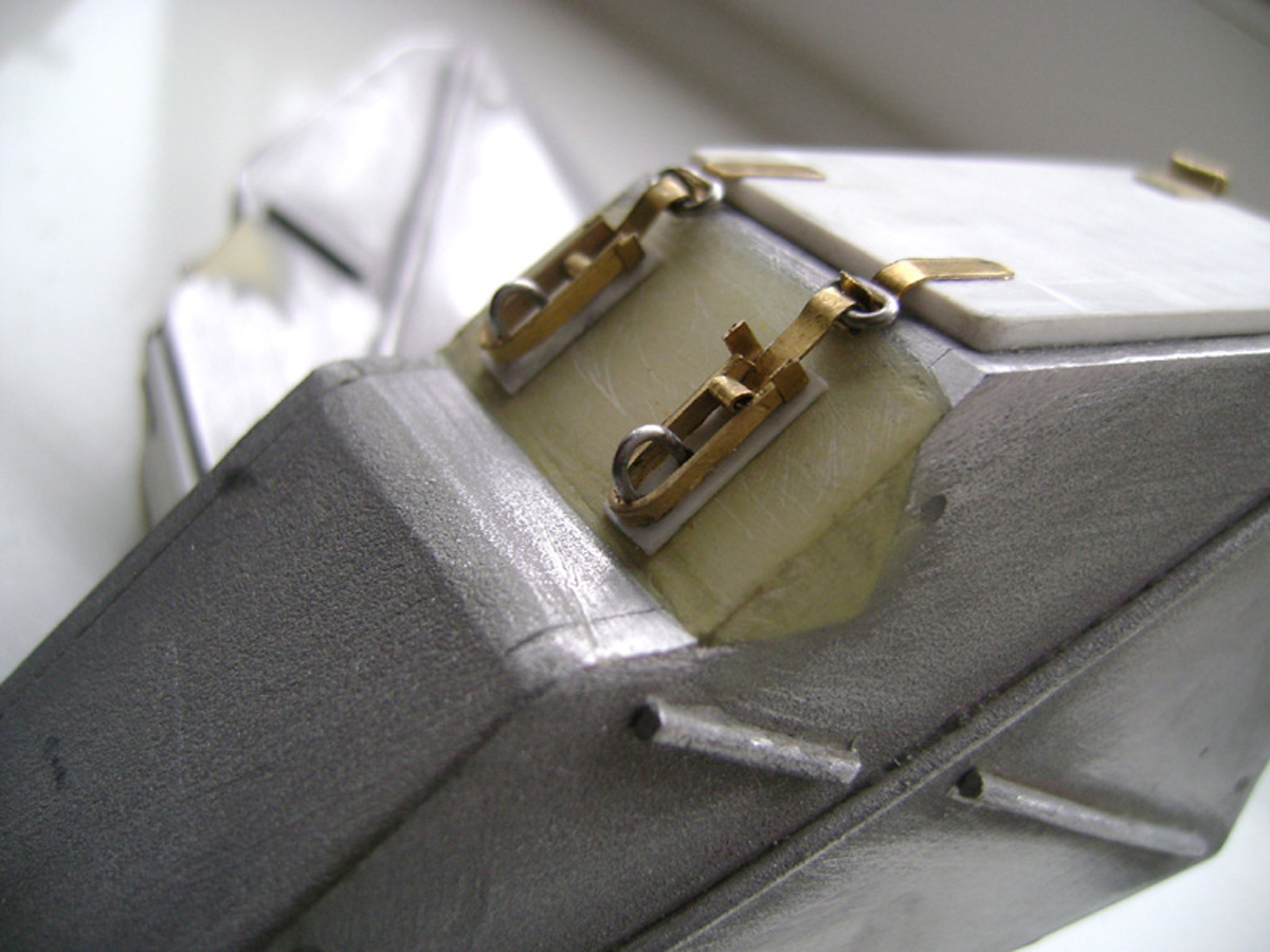

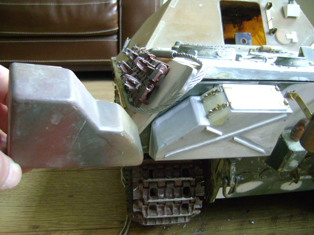

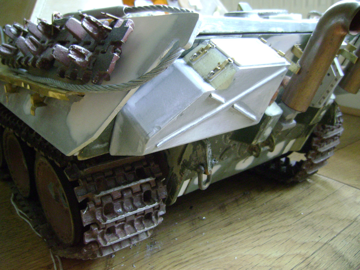

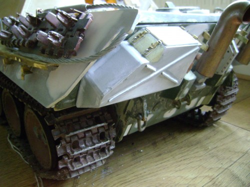

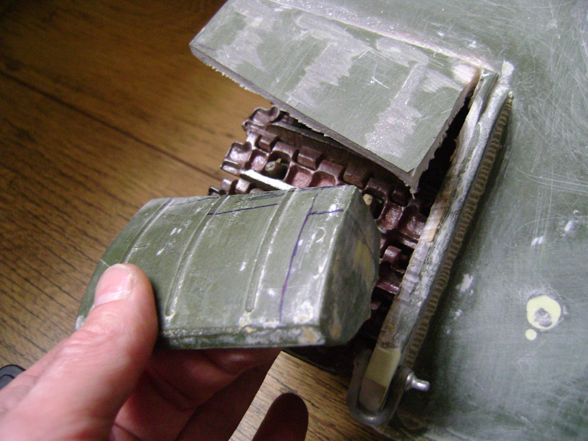

Work continues. The storage bins are finished and back on. I finally made the decision (which I should of made earlier in the build) to remove the fenders and create something a bit more accurate. I did them in 0.5mm brass and bolted them on with 6ba screws. Hopefully they will prove to e robust enough but if they get a little bent then this should add to the realism. I made one of distorted from the start to give that "lived in" look.
new one takes shape
new one takes shape
old fender off
old fender off
before and after
before and after
