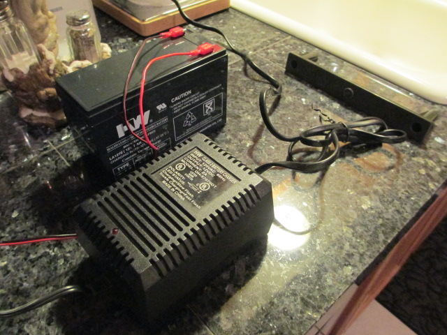

Posts: 7405
Re: Oh no! I did it! I bought a (used) Armortek Tiger 1! :-)
Good afternoon,
Following along with my friend, Gary's, thoughts, I considered LIPOs and also a motorcycle battery for keeping the Stuart 12v gig going. It depends on which mfu I end up with. Following along,
This battery will do better mounted lower in the hull to free up space for the deck details..JPG
