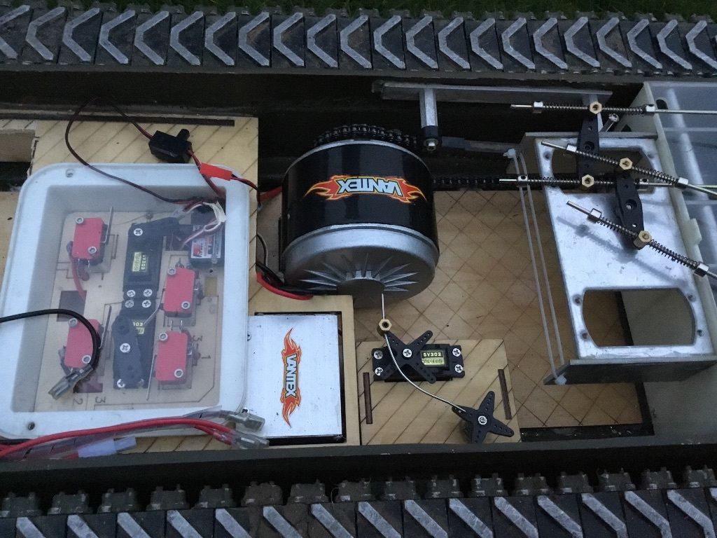

One thing I would say about the motor position is that the longer the chain run, the more slap it will have as it beds in, so you'll be adjusting the tension more often, unless you improvise some form of tensioner.
The Vantex Sherman I have has a length of acetal bar pushed against the chain, to tension it, but this does also add to the background noise when it's running.
You can see it top right in the picture above. One end is fixed to the hull side, the other end is pressed against the chain with a cap head bolt.
Adrian.
Adrian.
