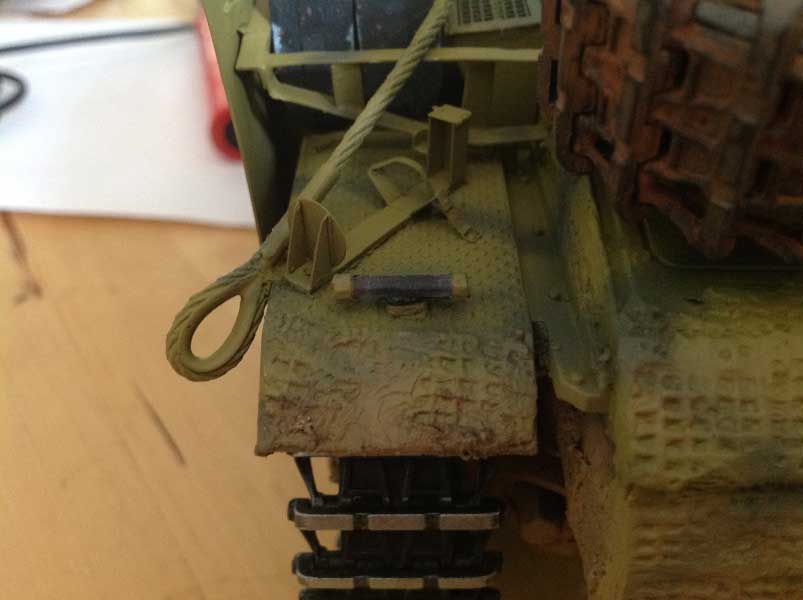

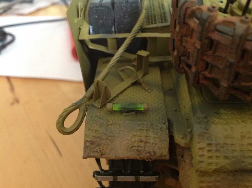

I saw that online when I was finishing my StuG, so I used two green SMD LEDs and a length of clear sprue.
Satin black off
Greenish glow on
