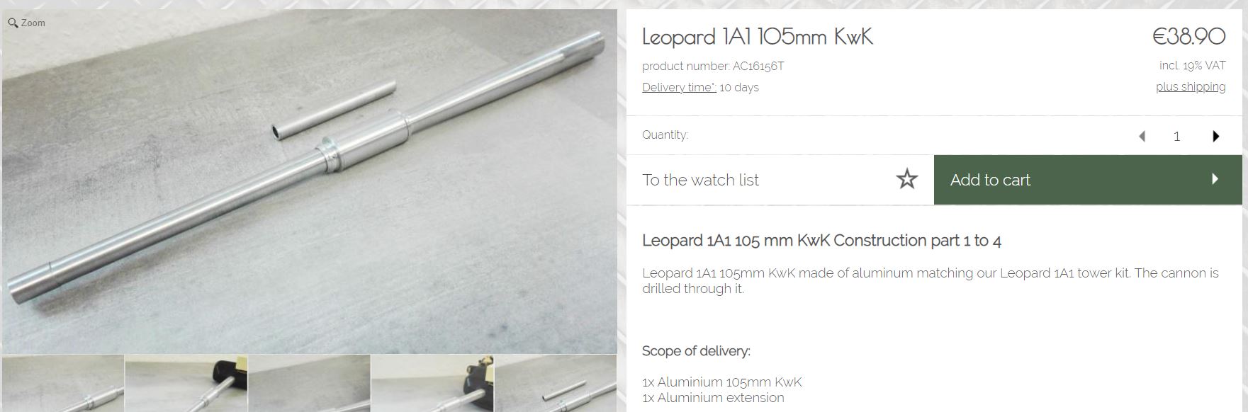

For an L7 105mm barrel, I would recommend the one designed for the Leopard 1 from AFV_Model. It is full metal instead of having the bore evacuator in resin, looks longer and seems to have an adapter to connect to a recoil unit. For the thermal sleeves, maybe Perfect scale Modellbau can separately sell the ones they include with the Leopard 1A5 turret. Their L7 is nice but designed for static display and too short to use with a recoil unit. Avoid the ones designed for a Tiran conversion of the Hooben T-55 kit, these are definitely too short at the breech.
https://afv-model.com/2657/Leopard-1-Le ... -105mm-KwK
