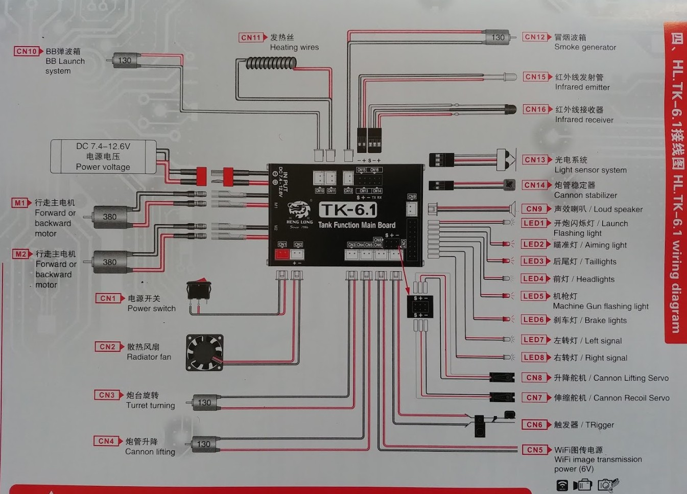

Here's the wiring diagrams for now so you can see what it's got-
One thing I did notice is a 6v power out for wifi cameras which makes me wonder what HL have got planned for the future.

Thanks, Woz. The Circuit diags. will be very useful. :thumbup: I imagine the 6v camera connection could be for an FPV unit.

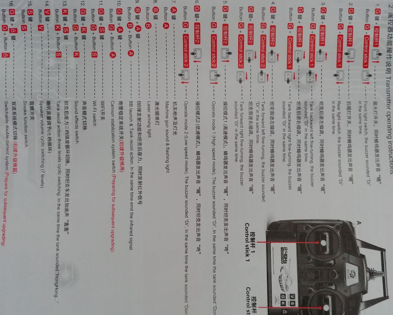

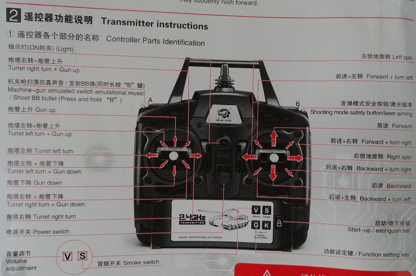

Anyway here's the controller instructions.

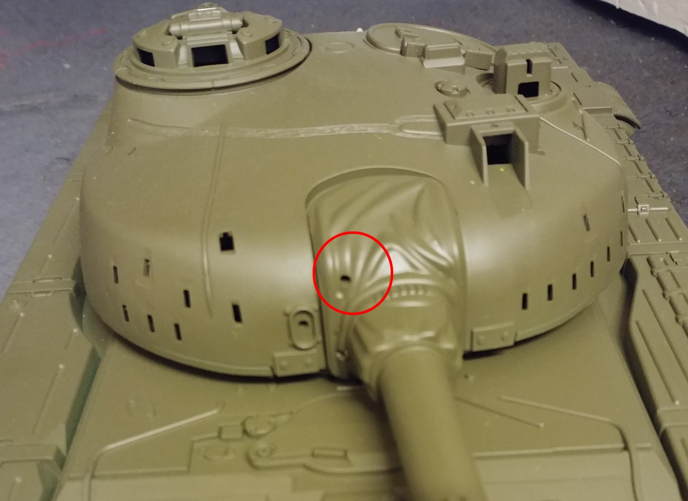

The IR transmitter is in the manlet next to the main gun-

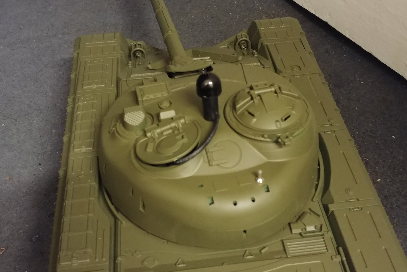

The IR sensor plugs in under the loaders hatch and the sensor has a magnet holding in place on top of the turret-

I see that on the instructions for the 6.1 version of the board there is support for servo recoil. Does anyone know if the 6.1 board is available yet and where to get hold of one?

MAKO TK6.0 will allow servo recoil on tk6.0 will also let you use taigen flash unit that tk6.0 doesn't
