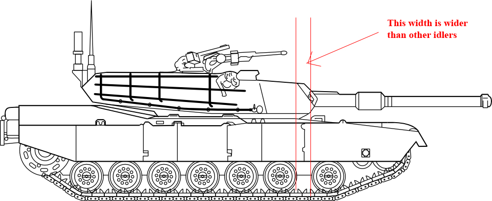

Hi all,
Got a quick question. Why is it on many main battle tanks the foremost/front idler wheel is further ahead, or has more space between it's following wheel than the other idlers behind it? Some tanks seem to have fairly consistent spacing in between all idlers but the Abrams and several others have more space behind that first idler. Is that to accommodate the fact that the front/leading wheel has a different arm angle than the following wheels?

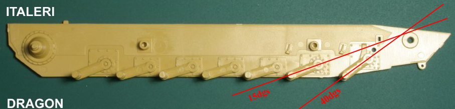

From some rough drawings it appears that the first idler arm on the Abrams is orientated much higher like ~40dgs and the other arms are much more laid down like 15dgs. So I'm guessing there has to be more space behind that front wheel because it takes the brunt of all obstacles and consequently swings a wider/larger arc then the wheels behind it. Also the front idler arm is mounted near the front of the hull which has the inclined angle and the arm couldn't be set at the same angle unless the hull was extended much further forward.
In other words it appears to me that the arm is angled as such because of where it's mounted. But maybe there is also a gain in having it at that angle because it rides over obstacles better than having it at a lower angle.
Can someone please elaborate why the Abrams was designed this way? And if i'm correct about the spacing behind the front wheel? Thanks

Weight distribution.
You have a heavy engine at the back, heavy turret in the middle and a driver up front.
As for the swing arm. The hull bottom is sloped at the front so swing arm can't be at the same level as the rest.

I think you're right, I think it's simply that the hull bottom is sloped so literally there is no room to put the swing arm at the same axis/position as the others. There's probably also some significant gain by having it raised up which allows that foremost wheel to take the brunt of the first obstacle much better if it's at 40dgs.

Ok, Ernie said the wider gap is to facilitate the rotary shocks at the two front locations...
Re: M1 Abrams Tank Wheel Spacing?
Remember 3-6 just have torsion bars and only need to be indexed to a point where the torsion bar can go in. The rotary shocks need more travel because the shocks are indexed at a higher degree be cause of more movement. That's the purpose of the spacing...
