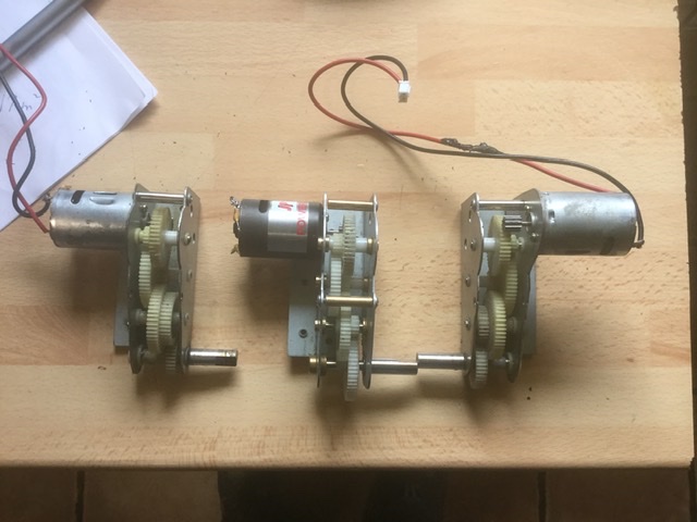

Have been thinking forever, if there was a way to reuse all the plasticgearboxes , with a lower gearing. They would be perfect for lighter tanks, that just need to be slowed down.
The picture shows from left , a standard HL, a HL with extreme low gearing, a HL like shown by Kazar.
Done with hand tools, but need a litle refinement. So consider them a proff of concept

The only problem is the gearbox you're showing on the far right. That's the high motor configuration, and it won't fit in a P3 and if use it in a P4 you lose your machine gun.

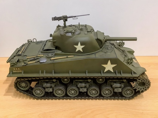

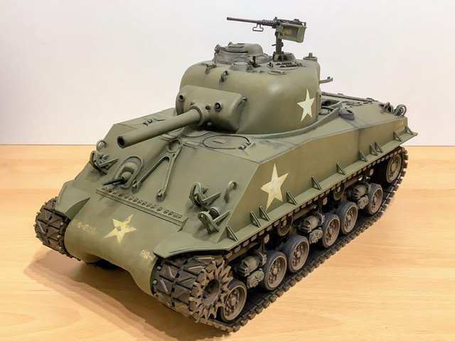

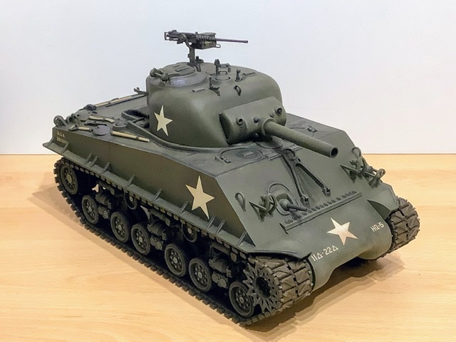

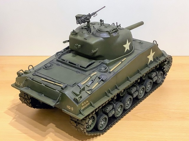

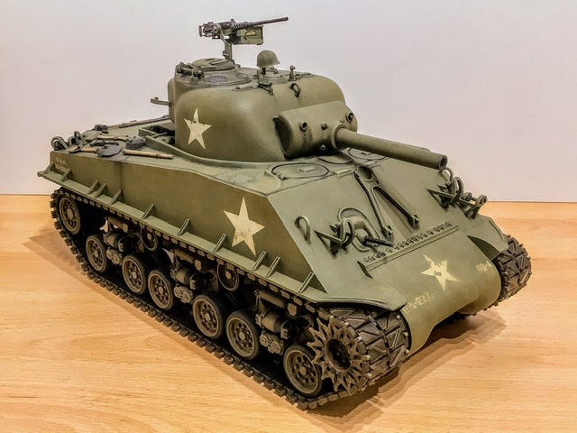

I’ve just finishing a complete rebuild & repaint on my two Tamiya 1/16 full option Shermans, one I’ve had for quite a few years that I bought new (dark olive drab) & the other (light olive drab) purchased some time ago as a none runner, now making a start on the Taigen Panzer III.
