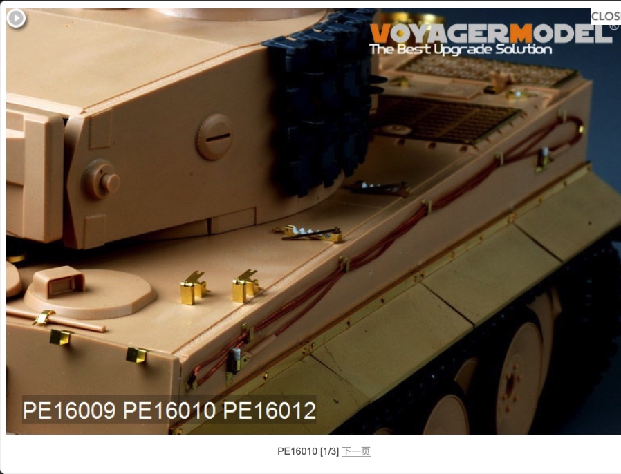

Incidentally, these are the side skirts I received (came free with a battered Tamiya):
Voyager Tiger 1 skirts
and this is the company:
http://www.voyagermodel.com/INDEX.ASP

P.S. ABER and VOYAGER are the big names in PE. I've worked a lot with ABER on 1/16 and a little with VOYAGER ( for smaller scales ) Both are fiddly but Voyager parts seem to be more robust.
