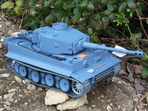

I just looked up 'Howes' at Kidlington and it is the same company that I bought my Panzer III from........So I ' Rang them up' to ask about the Tiger 1 as I cannot see it on their website.....
Unfortunately they do NOT offer the exchange 3:1 reduction gearboxes and rather surprisingly they do NOT stock them either ...So you WOULD need to change or modify that. I asked the sales assistant about the Gun Mantle, gun length,the Commanders cupola and the pistol port and unfortunately he did not have any idea about those parts .... ........I thought that Heng Long is now so big that they were no longer afraid of being sued by Tamiya for copying and that all the deliberate errors had now been corrected.......BUT.....I now 'found' the Tiger that 'Howes' is selling ....see below..... .
Is NOT correct !!.......The gun is too short, the mantle is upside down and the commanders cupola is fitted at the wrong angle ( so probably is the pistol port )....SO ...possibly these are 'Older' versions of the Tiger that Howes have upgraded to sell on faster.......The jobs are NOT hard...but its more things to do if you want to put the Tiger right.......BUT....that is also the fun with the tanks....Modifying them and making them 'Yours'... ......It might be worth contacting Steve at Welsh Dragon and asking about 'Upgrading' the Torro..the upgrade parts are available in his shop but the 3:1 boxes are £ 45 and the tracks are £70 at the cheapest..............Sorry, not to be of more help....but If you need anymore info please just ask.....

Thanks for the welcome guys, bought a HL Tiger 1 today with metal tracks and gearbox! Very happy so far although the dog now appears to want to leave home. The gun appears to be the correct lenth although the mantlet does need turning round, the cupola was loose so i have turned that round already and i think the pistol port is correct off top of my head but will check later, all in all very happy and for £99.99 not bad at all. Got quite a lot of plans so will keep you all posted on ho w its coming along. Any advice would be most welcome as i'm a complete novice to the world of RC Tanks, my misses thinks i've gone mad but we don't really listen to her, taking her to tankfest soon! Anyway guys must go play
