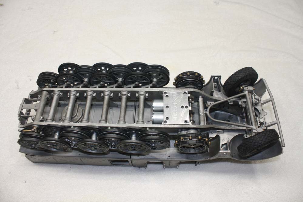

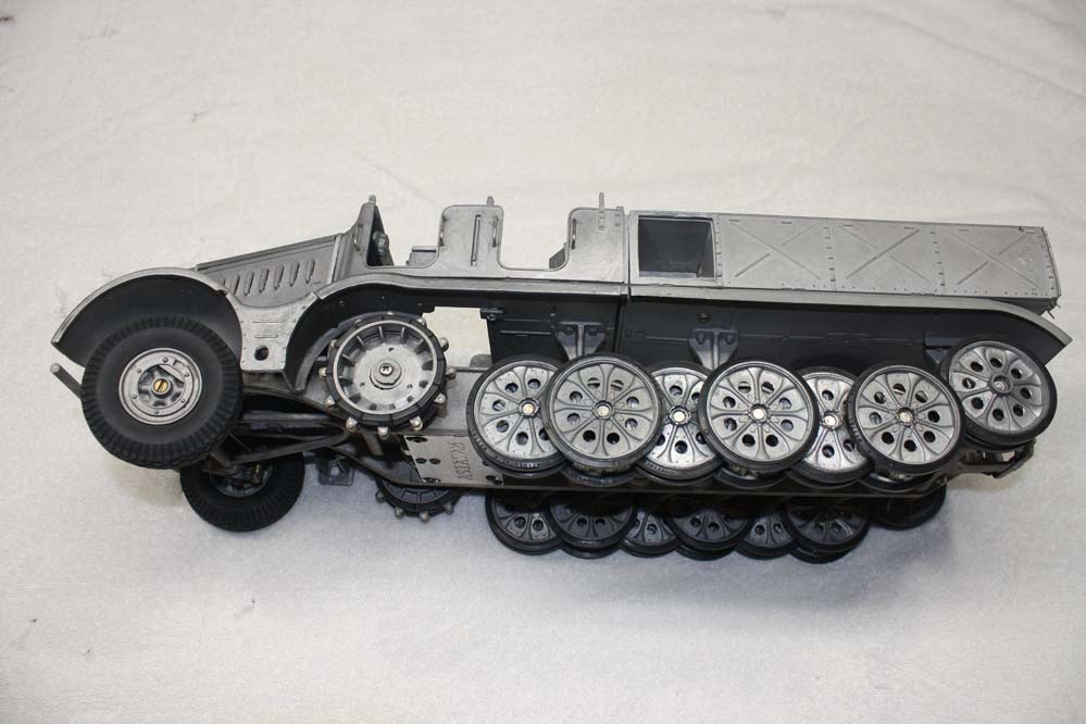

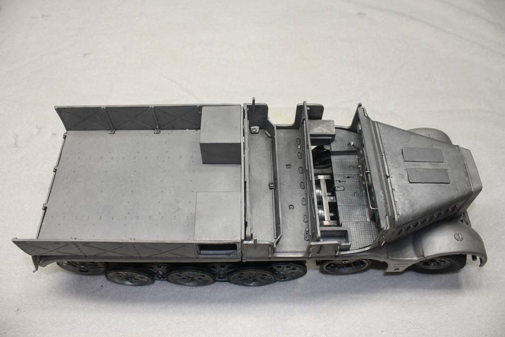

Those of you who have built the Asiatam Famo can help me limp through this one. I am going to take on this project despite a paucity of skills, as demonstrated by my WCP 4X4 build at viewtopic.php?f=23&t=32221&hilit=Jeep.
I have a few print sources on the Famo, and lots of others online. (I have to go into town to get any internet connection, so I don't have the sources to cite them, but I can get them a.s.a.p.).
For starters, here is part one of my current inventory. I can identify most of the detail parts, and I can see how to disassemble the main body and chassis. However, the electronics will be more of a challenge, so after this inventory, I will have an initial question.
Famo Inventory _01.JPG (70.71 KiB) Viewed 83783 times
Famo Inventory _03.JPG (87.59 KiB) Viewed 83783 times
Famo Inventory _05.JPG (89.28 KiB) Viewed 83783 times
