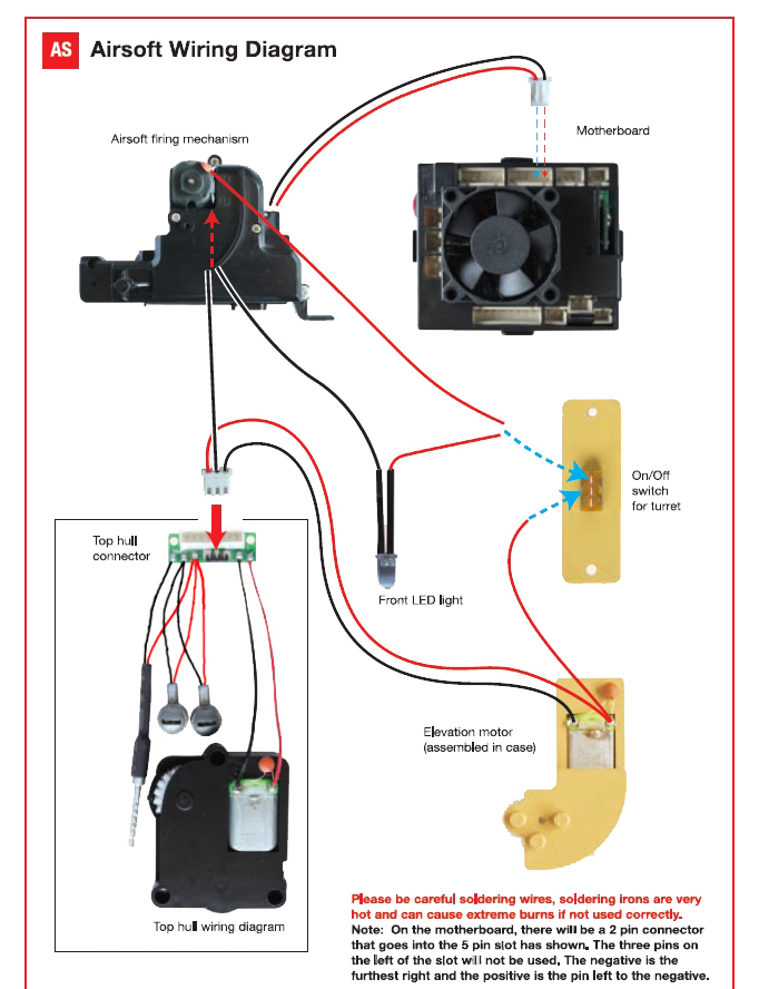

The airsoft safety switch wiring looks like this, GJ: This is for Taigen, but it was essentially the same at that time.General Jumbo01 wrote:That's no problem, now there's at least two of us looking for the same solution! We've been searching for ways to turn off the hull recoil, now done for us, so make enough fuss and you never know....
I seem to recall there used to be a bb gun switch fitted beneath a hatch in the various turrets so I'll explore some of my earlier models to see how they were wired and what affect they had. I'll let you all know BUT if anyone can add anything, please do

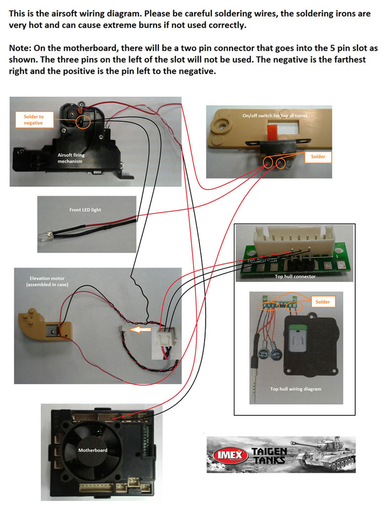

Re: HengLong v6 cannon firing
...and another useful diagram- again Taigen , but the HL had the same switch wiring...
Click to ENLARGE"Get your facts first, and then you can distort them as much as you please"- Mark Twain.

From those diagrams (thanks) it looks like the switch turns off the power to the red firing warning led and the airsoft motor. It would be easy to add a switch to do the same job but l wonder if it would negatively impact the firing associated functions, like sound, barrel recoil, flash and smoke but IF those are all controlled within the MFU then it could be straight forward. I'm still waiting for a recoil barrel with flash and smoke to be available as an upgrade.
(Edit) I'll try fitting a switch and report back asap
