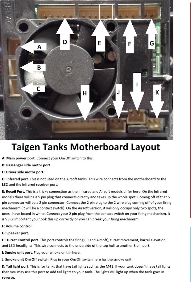

Hi all, looking for some much needed help and advice if possible please? I have recently started to build the Taigen TT 1 much to the fact that i love modelling, in particular weathering etc. My tank is infrared capable but I don’t any experience when it comes to electronics. I have followed what I can from the instructions but I am really struggling in knowing which lead connects to what part of the mother board. I believe I have all the right parts but cannot be 100%. A really simple ‘what to do with any pictures’ would be ideal I’m sure to get me on the right path. I can’t seem to find it on YouTube etc Any suggestions would much appreciated!

Your best bet is Google images, search for the board, click on images, and find the one that you have, there are loads on there.

Not sure how recent your model is, but here's a selection of connection diagrams. You can also download a reasonable (pdf. format) Owner's manual for the TT1 from Taigentanks.com in the US.

Clicking on the pics should enLARGE them a bit...
You can download these and more details from Taigentanks.
These are a few examples of what you can find if you dig around the Archives here, or from the 'Net.Download your User Manual from here, if you've not already got one..

Many thanks for all of your responses - enough there for me to kick it off
