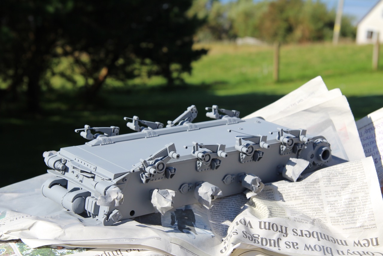

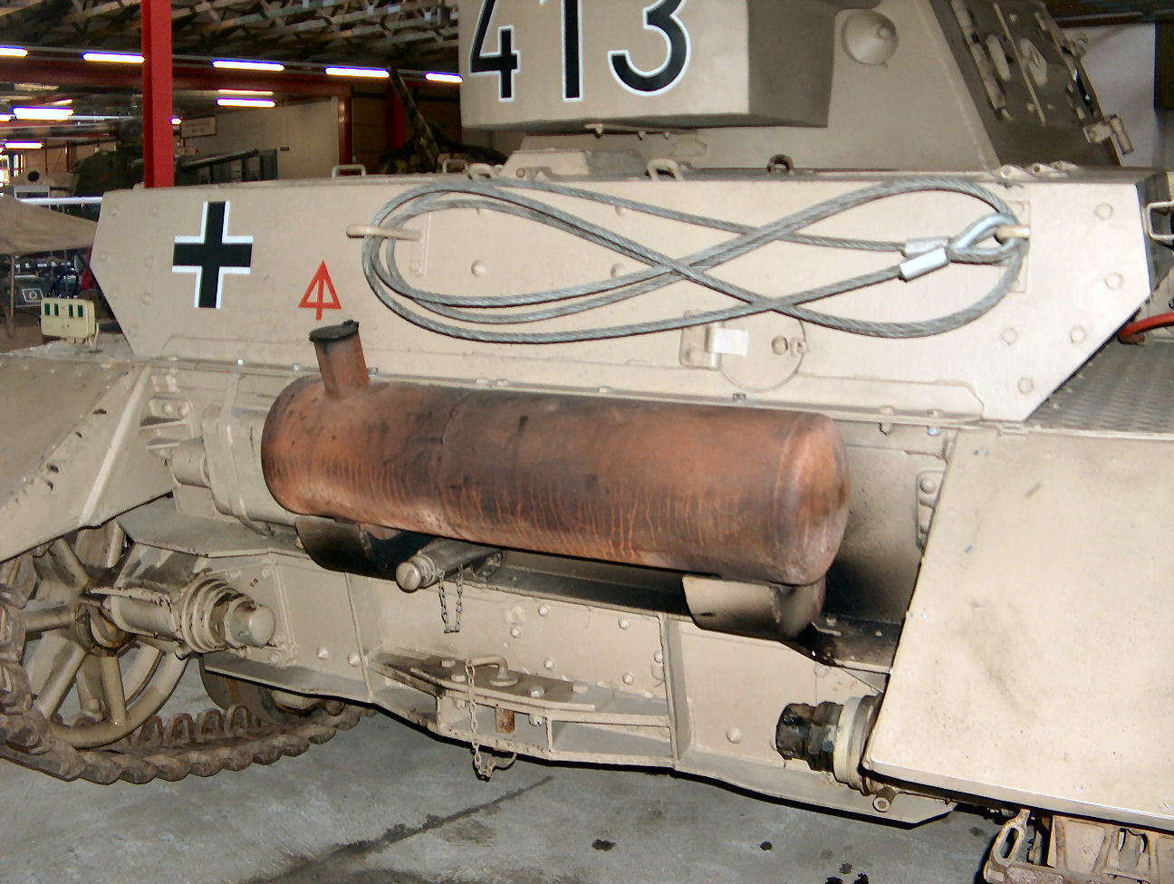

I'm not sure about the 'prototype' adjuster on the real Pz IV, Shaun, but (loath as I am to to praise the Asiatam effort in any way) I'd say that the Asiatam model offers a fairly good approximation of the real thing. Just compare these pics: my Asiatam (after sawing 9mm off the rear end..
) and an ausf. 'G'.
