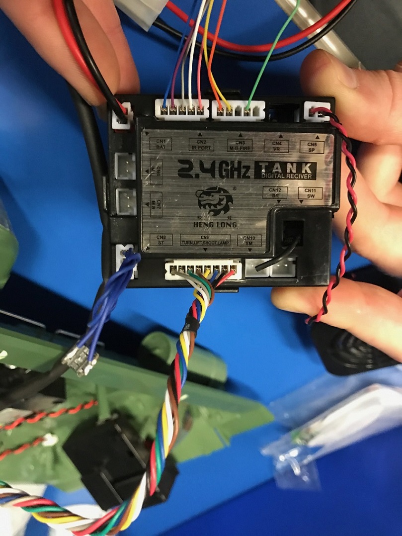

hi dave have fitted the taigen infrared t34/85 turret & upper deck everything works eccept the recoil & flash , all wires connected to mfu correctly 5pin with 5 wires to cn2 , other 5pin with 3 wires to cn3, 3pin connected to small board next to 8pin on hull top , red wire & black wire for turret m/g connected to hull m/g, gun up/down works, turret l/r works light works, tanker 242.

ps, blue wire connected to battery negative switch in turret turned on,

hi KT , no it dose not every thing works normaly eccept the recoil & flash , dave from forgebear is talking to taigen about it as someone else has the same problem , tanker 242.

hi. got an answer on the wiring. here is a pic showing wires. you just need to move the one green wire one peg along as per the picture. this is for the heng long 2.4 for taigen the wiring does not change. let me know how you get on. dave
