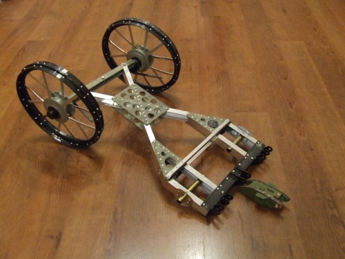

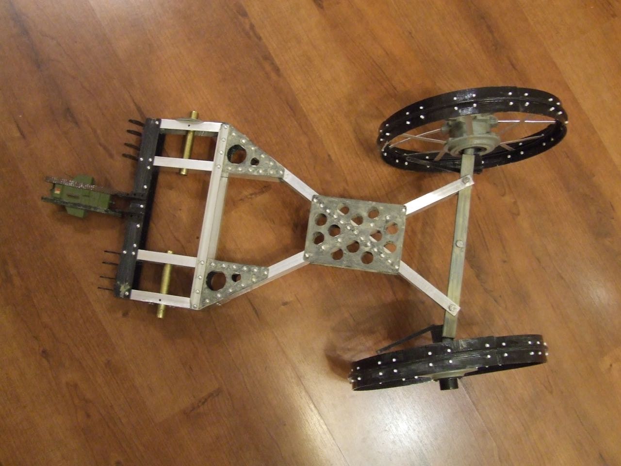

A bit of progress on the Tank this week and a bit of a landmark.... I've finally built the Tail Wheels!!
Ok there is a lot clean up to do and there are a few details and build issues to sort out, but feeling a bit more confident about having it all done for Bovington now.
