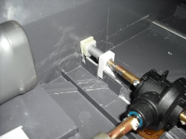

Well I decided to refine the axel supports to prevent it throwing the track and to keep the drive srockets aligned and prevent wobbleing of the drive train. I had a couple small nylon gears about 1/4" thick so I drilled them out to match the diameter of the aluminum axels, then trimmed them and epoxied them to the sides of the hull. I then made the inner supports from some 1/4" styrene for the inner supports. Since this isn't a race car the styrene should last along time with some plastic safe gear lube. Here are a few updated pics of the drive train and the radio instalation. I would love to get a sound modual of some kind to simulate engine sound that increases with the speed of the halftrack.
