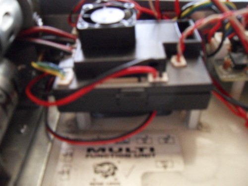

Are you sure th tracks and especially the drive sprockets are the correct set. But then as you have said the is no torque. have you tried to wire the motors directly from a battery? This would eliminate to control system as a cause if the condition is still present? If not the the RX18 unit could be at fault. Smoking motors are bad, do you still have the factory motors? Or are these in fact what you using? Are they mounted correctly? Are the pinion gears aligned correctly?
I am just suggesting idea's, trying to establish a process of elimination. Seems the motors are pulling to many amps, overloading the RX18. Try removing the motors as well, test with a direct battery connection and try to stall them.

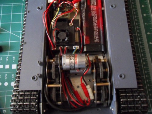

Gruapner speed 400 motors, in my 20lbs. Tiger for over a year, torque and smooth operation. I have the Asiatam steel gearboxes 3:1 ratio 12tooth pinion gears or 11 tooth. Available through RCTANKWARS,OR Hobby Lobby Intr. Their not expensive and they work. Now Dave or Steve may have them I'm not sure? I will list all four links. The motors are 7.99 each through HBI. Dave Forgebear can be PM messaged on the forum, he may have these I just don't know.Also the link for fan cooling the RX18 IS INCLUDED
http://www.rctankwarfare.co.uk/forums/v ... +RX#p40142" onclick="window.open(this.href);return false;
http://rctankwars.com/" onclick="window.open(this.href);return false;
http://www.hobby-lobby.com/speed_400_7. ... 0_prd1.htm" onclick="window.open(this.href);return false;
http://www.welshdragonmodels.co.uk/" onclick="window.open(this.href);return false;
Jono77
