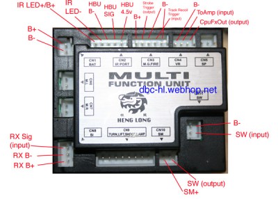

There is only one way to plug the HL muzzle flash into an RX18.
You pull out the two pin plug at the top, plug in the 5 pin, and then plug the loose two pin into the muzzle flash two pin (brown/yellow I think).

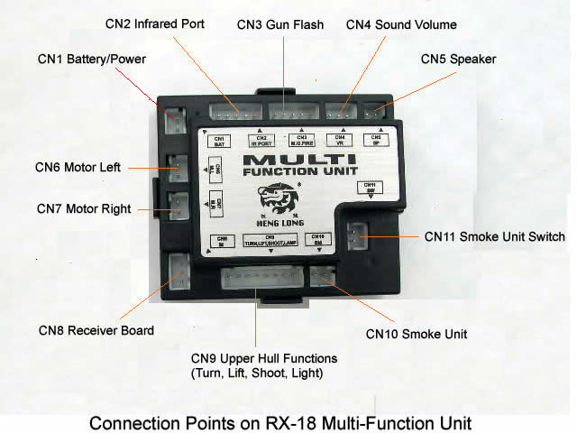

Here are a couple of pics if they help

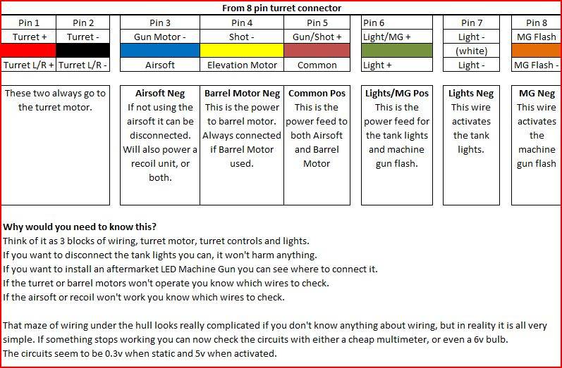

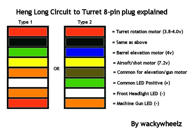

Hey Boxerdog,I have these they may be some use at some point.And the mod xrad mentioned is on rccommands site,I have airsoft with recoil but it combines recoil,tank recoil,and gun firing all with left up stick.I/R should work like that as well but I don't have I/r at this point.Hope these are useful. Sax (note:I cannot credit three of these drawings,I did not create them and not sure who did) Blake

Real nice rx18 dgms, guys!

I just want to reiterate I did not draft these diagrams.But they are real helpful and well done. Saxondog
