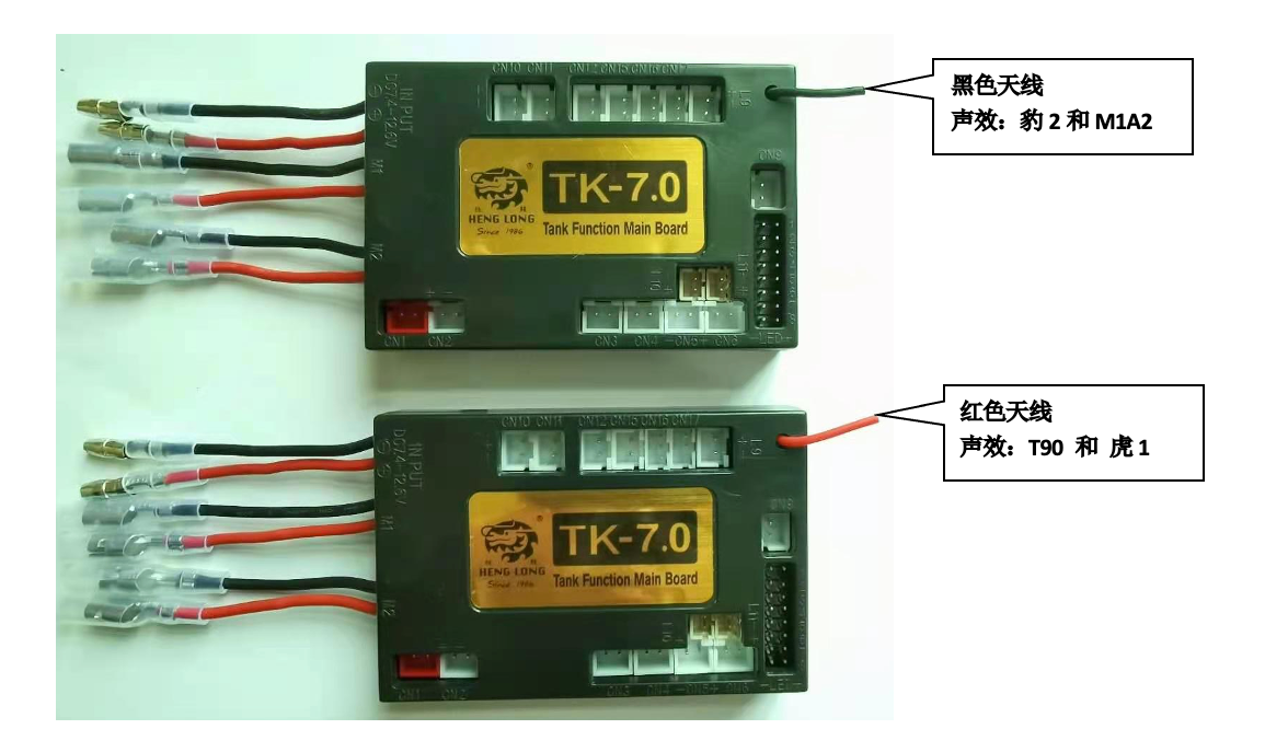

hi guys i have new stock of 7.1s and yes it has the right side slider trim on it also the way to tell the sounds on the boards are from the 2.4 Ariel on the board the one with red is tiger and t90 the black is leo

I wonder what has been going on with HL and the V7, and the information they have made available. The instruction sheets I have clearly show the slider on the controller, and CN2 is on there even though neither of my 7.1 units have a socket under the hole in the casing. I’d be interested to know if anyone out there has an expanded explanation of the functions shown as ‘7.1 only’ in the instruction sheet. I have one each of the black and red aerial units. Again, I’m wondering why HL has not publicised this info - unless I’ve missed it. They seem to have up until now left it as a lottery as to which sound set you get. As a footnote, I have the red aerial unit in a T-72. I read somewhere that the T-90 has a gas turbine, but it definitely sounds like a diesel when running, but with a turbine whistle when throttled down. A bit of both, perhaps…
