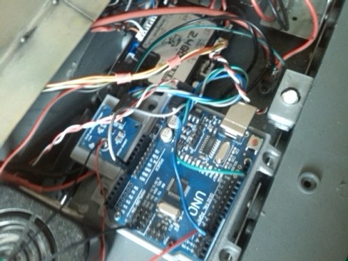

Just a quick pic to show the Uno mounted in the hull.
I have used the add on board for the emitter, as this comes with the circuit protection shown on the schematic. I desoldered the emitter and installed fly leads so that I can mount the emitter in the mantlet, but swapped it for a Maplins one as I have a bag of them.
The add on board for the sensors has not been used. I desoldered the single emitter, but they have used some kind of sandwiched solder joints onto the pcb, and it has proved impossible to solder fly leads or pins into the empty holes. I will just hook up sensors as shown in the schematic.
A jack plug has been wired into the tank switch, so that the board is powered up when the tank is switched on.
The IR works, just need to attach the wiring to the 5v IR pins via a voltage divider (just two resistors).
The sensors are not yet installed. Need to modify the cupola and glue those in.
The muzzle flash was wired into the HL IR emitter pins, however, these will now be used to trigger the Uno, so I will have to either install an HL high intensity flash or find another way to wire one in.
I'll also try adding a servo recoil when all of these tasks are completed. It all looks a lot more complicated than it really is, this is quite an easy installation.
