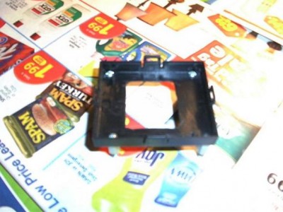

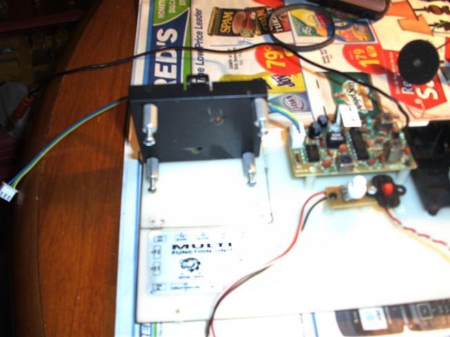

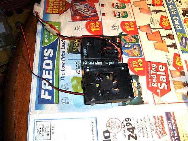

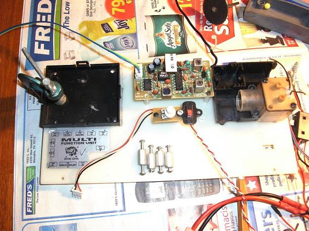

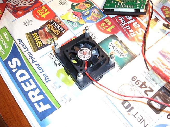

After some thought and realizing that I had limited space how could I fan cool my RX-18 with maximum air flow.First I started with a fan cooled unit from Bill@rccommand.com This unit has a pre-installed small fan wired to the power input socket,OK some cooling.Then I read where most often it's the motors that over heat the board and air not circulating though the RX-18 unit,then I had the idea of raising the unit and cooling it with a fan under the unit pulling air from top to bottom,as it pulls in fresh air from the top,it carries heat with it and blows the heated air out the bottom.Here is what I did.

Not to steal your glory, but for added safety , I added an inline 5 amp quick blow fuse on the red power to board ...fuse will not blow if normal track motion used, but flash and track recoil burned the fuse. So I track motion disabled with modellbau unit and this seems to work. Probably need a 7.5 amp quicky.

The power lead has a 5AMP Quick connector,these are normally used when we install L.E.D.Lighting system on motorcycles,their a great little connector up to 15amp and 12ga wire are available,But I have not burned one yet.Prior to this mod I had damaged a RX-18 UNIT and since the fan install and the fusible connector I have had no problems,also 3:1 ratio gearbox w/12tooth pinion helps. Which modellbau unit are you referring too? Sax
