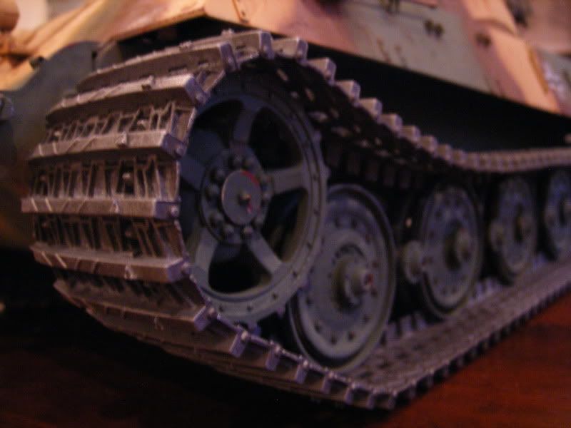

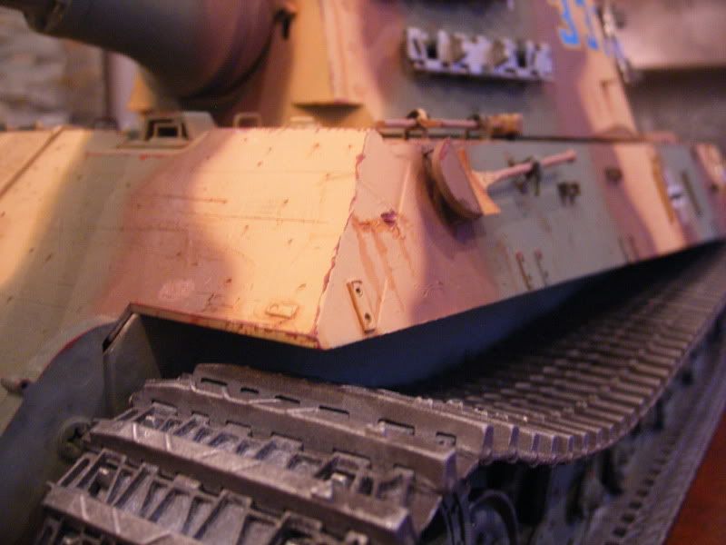

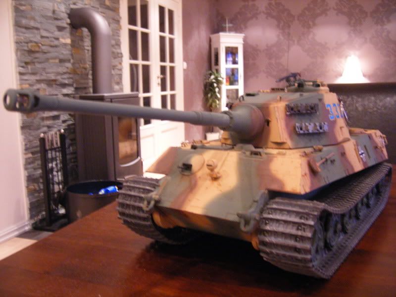

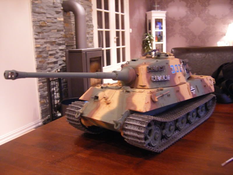

Here is my three tanks including my friends Sherman which I rebuilt and upgraded for him.
HL Tiger, fully equipped from Rctank.de
Metal tub with torsion spring suspension from Impact
Ballbearing upgrade in idler and roadwheels made by me.
Metal tracks 2x battery's etc. Weight 6,5kg's.
Tamiya King Tiger.
Impact suspension upgrade
Impact later metal tracks
Kenny Kong 18T Sprockets (Not in pictures)
Impact recoil
Impact Transmission units
Impact elevaton arm
Impact PE kit
Impact Sprocket guards
Asiatam roadwheels modified to take 2x ballbearings
Asiatam Sprocket gearcovers with support bearing.
New larger mechanism deck
Gearbox support brace.
Modified idler adjustment to fixed.
Integy "servo slow" unit to simulate real tanks inertia.
2x5000mah batteries
Weight 8,5kg's

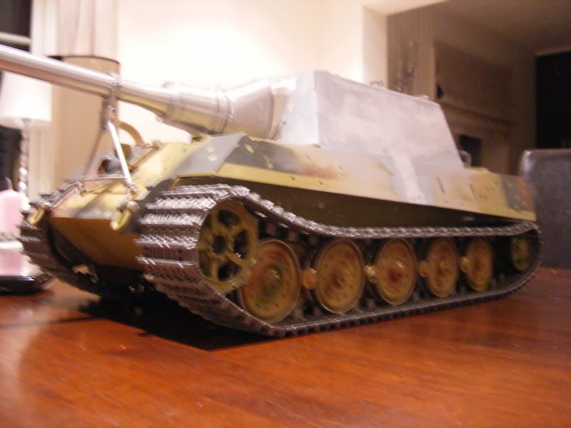

My last ongoing project.
Modify a early single motor Tamiya King Tiger to a full option Jagdtiger.
Lengthened hull
Added inner skirts from 30x30x3mm angle aloy(missing on early Tamiya model's)
Large mechanism deck in 4mm aluminium.
Gearbox support from 30x30x3mm angle aloy
Stretched superstructure.
Maingun, charlotte, exhaust covers, detailing etc from Wecohe.
Impact recoil uppgrade.
Impact tracks for 9T sprockets with extra tracklinks.
Impact sprocket covers.
Asiatam tow shackles.
Asiatam roadwheels.
Asiatam sprocket gearcovers with ballbearing fitted.
Tamiya twin motor gearboxes with 3:1 gear reductions mounted.
Homemade bumpstop on first and last roadwheel pair.
2x5000mah batteries
weight 10+kg's
Remaining things to do is:
-Fit recoil unit
-Fit elevation motor (same as traverseunit)
-Add limit switches to elevation traverse circuit.
-Fit Tamiya DMD/MF unit's
-Puchase new trackhangers from Schmou (Wecohe ones were missing a lot of the parts and were poor casted)
-Paint and weathering.
My friends Tamiya Sherman FO
Impact metal tracks
Impact sprockets
Impact Idler wheels
Impact return rollers
Impact Ballbearing kit
Impact Output shaft support
Impact Firefly maingun barrel
Impact elevation arm
Integy "servo slow"
Quite a difference in size. ;D
