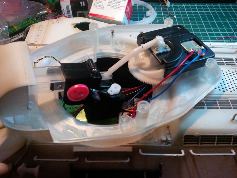

Arnie, it would definitely be easier to replace the recoil with a HL unit if you are using Taigen electronics. I upgraded to servo recoil with Clark electronics and did managed to salvage most of the WSN recoil which in my opinion is actually better than the HL ones..... Here is a pic:Arnie_DK wrote:Thanks
I had come to understand, that the Wiring in the turret could go into the new board, and with a bit of clever re-wiring you could also make the gun recoil work?
But it might be easier to just replace all the stuff in the turret for HL/Taigen parts you say?
You stillhave the complication of integrating the WSN elevation unit with the HL unit........ Maybe others had done something similar ?
