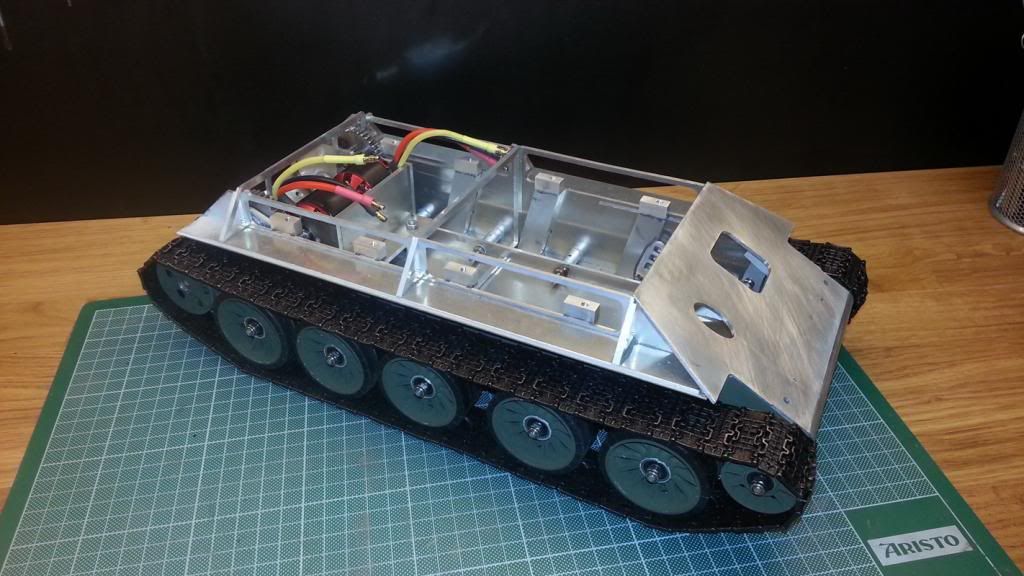

From the begining - hull:

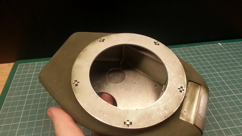

Turret:

This weekend I assembled the suspension and run a few test. Summarising - I'm in love with elmod flex module and option to use burshless motors :)
As planned I removed a few upper parts of turret's frame. Now I have easy access to the turret's interior.

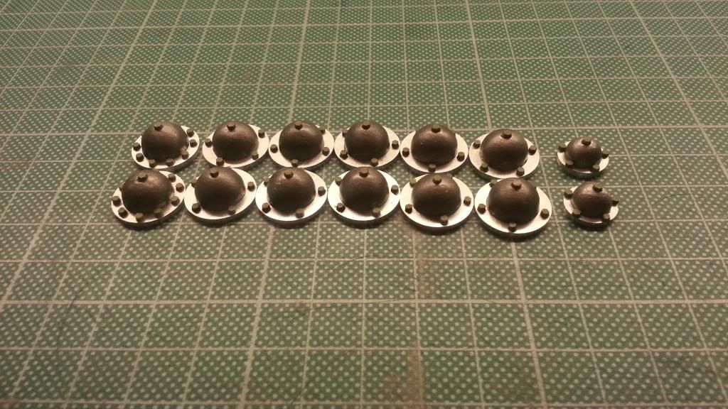

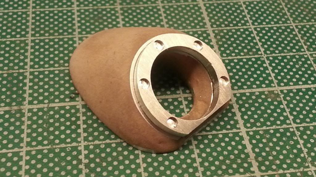

Finally I "invented" a method to make a wheel covers :) And here thay are:
The spheres are made of 0,5mm thick lead sheet pressed in aluminium form with a steel bearing ball.

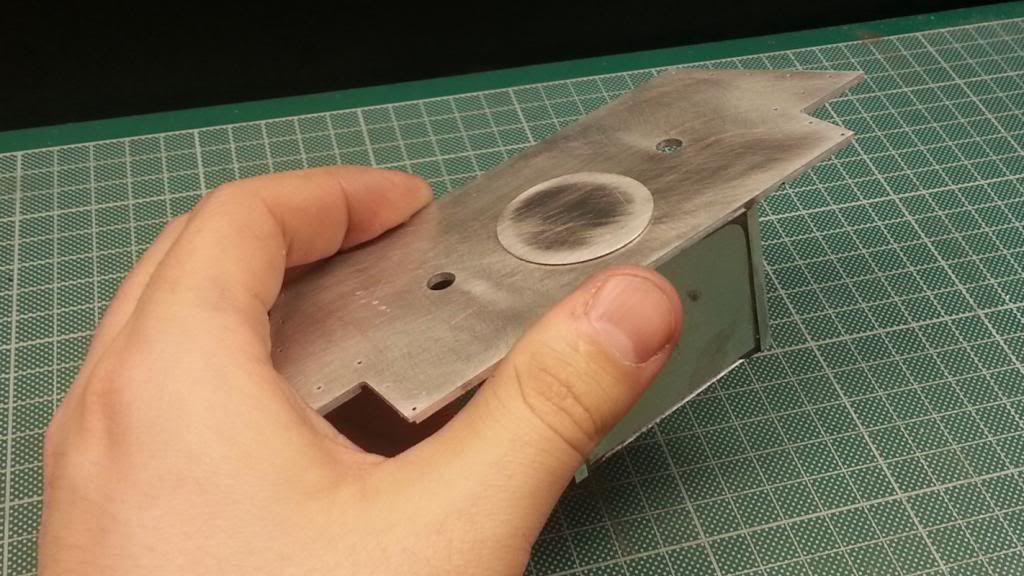

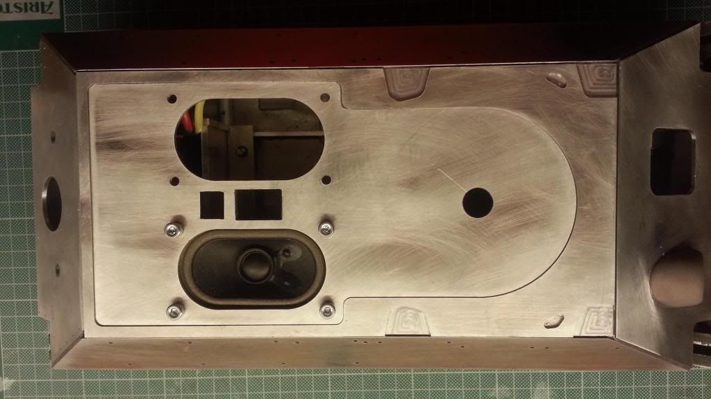

Upper part of hull is made of two parts - one will be a sort of cover allowing easy (I hope...) access to the interior.
Barrel is a small experiment I undertook. To fix it in the turret I'm using a linear bearing (a small and cheap one, usually used in cnc machinery). As the result - my barrel is not hollow :( I had to use original steel rail because bearing didn't want to "cooperate" with bearing which is already fixed inside the gun mantlet.

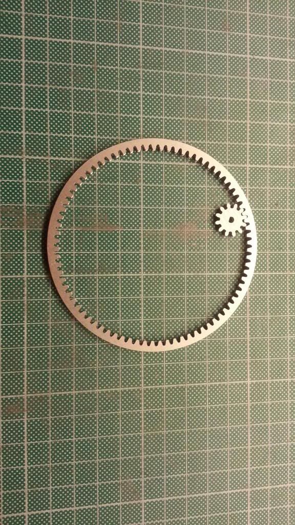

And this is little "something" I'm really proud of :)

jaw7620
Posts: 54
Joined: Fri Jan 24, 2014 11:39 pm
Re: T-34 aluminium scratch
Post by jaw7620 »
That slew rings excellent work Van do I see some being offered for sale ???
vanhasen
Posts: 65
Joined: Wed Aug 01, 2012 12:28 pm
Location: Katowice, Poland
Post by vanhasen »
I don't intend to start mass production :) My methods are not adequate - it took almost one hour to cut this ring.
And what's more important - this one is functional, yet not perfect.
