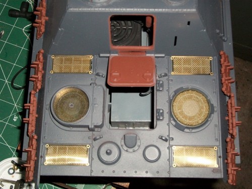

Excellent observation of the control arm issues,I will follow your example on my Jagdpanther. Also interested in the grills and how you install the one over the Fan blades or under loosing the fan? Just an issue I have seen this done both ways,and it would seem practical to cover the moving fan blades. Will watch with interest, Saxondog

Saxondog wrote: Also interested in the grills and how you install the one over the Fan blades or under loosing the fan? Just an issue I have seen this done both ways,and it would seem practical to cover the moving fan blades. Will watch with interest, Saxondog
Sax you talking the crew heater box one on the rear deck, or the RX18 cooling fan?? I have a "trick" up my sleeve for the rear deck, but going to leave the board fan open (the turret crew will have to watch thier feet :haha: )

Rear deck left side with external fan blades,the grills are to small to cover the fan properly. On my Jagdpanther this just bothered me to a point but I have stopped that build until this post when I started to consider this issue again,as for RX18 cooling all my tanks have the same elevated double fan cooled system started in my Tiger.
Small fan on top,board mounted on stand=off nuts and the large fan on the bottom compete circulation and never fried a board yet. Also use the Asiatam component tray for compact ease of install and simple uniform design.
But hey your skills are well beyond mine so please continue and I'll follow with interest. Saxondog

The external portion is the screen support for the crew heater as far as I know....
Not much of an update as of yet, but I did breakdown and order a Tamiya turret and exaust arrestor parts tree for her yesterday. I am hoping to get started on the upper hull later today..
