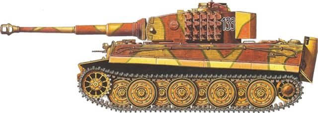

Thanks - Ebbey is coming along now at last ....
I thought I would go for this .........after all every Tiger needs its stripes !!!
Andy

Oooh , Nice . The 'ol 510th heavy armoured unit , July '44 scheme eh? Very tasty . She'll look good .
  • I havn't decided what i'm doing to mine yet ( june-july series), but i'm leaning towards an Italian job . . . maybe .

That , folks isn't a Funny lookin' K.V. , but it's antecendant , the german answer to it . Some tin can they called the Tiger or some such thing . ;D never fear , no such decadence for our valiant comrades in the glorious red army , there's nothing wrong with a coat of soviet green paint . . . with a fetching hue of sh*te splattered on for good measure .
