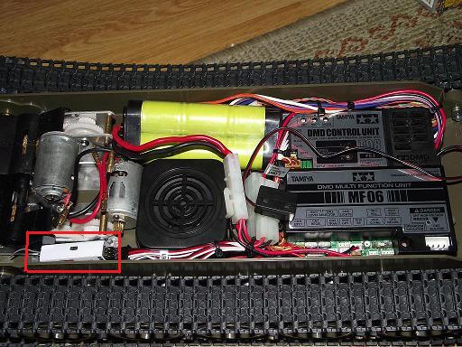

hi sudbvr just a pic of mine with tamiya dmd/mf units ,the main cable you need is the comunication cable which will plug between the two units, you can get these of ebay quite easy.
robert

stupid question yes but unless you know then no, and no the receiver is not built in and you do need a seperate one, mine is in the left hand bottom corner by the side of the motors. the radio i use is the planet t5 sets which are 2.4g with self added toggel switch to help with firing the guns and turning on the lights on my tanks

just had a quick look on ebay for both units under £200 for the pair.
robert
