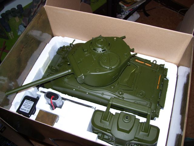

my sherman arrives today will post pics as soon as it arives then will disassemble it for more pics of the components and my review

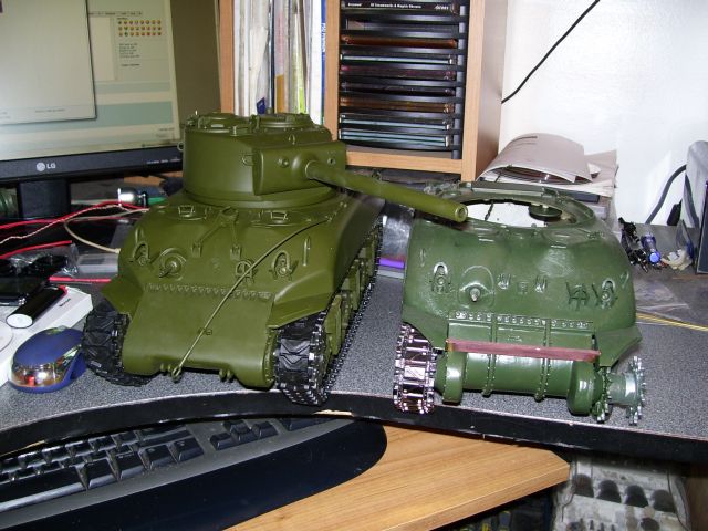

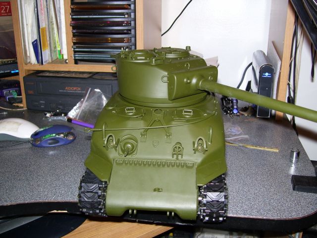

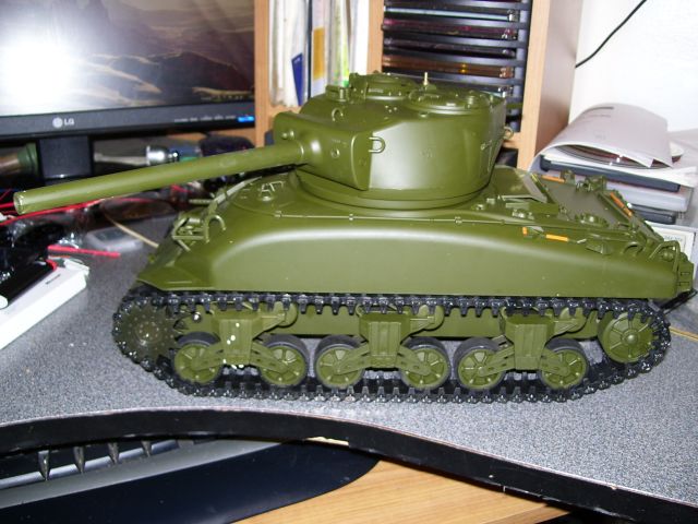

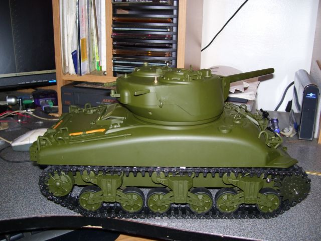

first impression not impressed at all barrel way out of wack tracks to wide no suspension just rockerboxes out of scale to wide turret to tall incorrect detailing on shell port hatches that open but you cant use to shallow hull to smooth no texture at all more to come once the battery is charged

Seems there is plenty to fix on it then. The only bit im interested in is the running gear. You said the suspension is just rocker boxes, is the no spring in it?
What about the tracks, just plastic, or metal as well? Is the sprocket and idler plastic or metal?

well just tested the running gear sound and turret controls running gear is ok but lacks suspension so it hase a hard time going over obsticals the sound are not of a continental radial the sound like a bad running 4 cyclinder perkins at idle but track sound once you start moving are ok with the track squeek turret controls are good but no sounds and the airsoft fire has been moved over to the button pad and gun elevation is now up and down with the left stick and the same for right left movment but no sound for these movments will pull it apart now to se the internals

grim_marmazet wrote:Seems there is plenty to fix on it then. The only bit im interested in is the running gear. You said the suspension is just rocker boxes, is the no spring in it? these is no independant movement of the bogies the whole boge rocks back and fort with a centering spring
What about the tracks, just plastic, or metal as well? Is the sprocket and idler plastic or metal? tracks are plastic but real beafy plenty stong

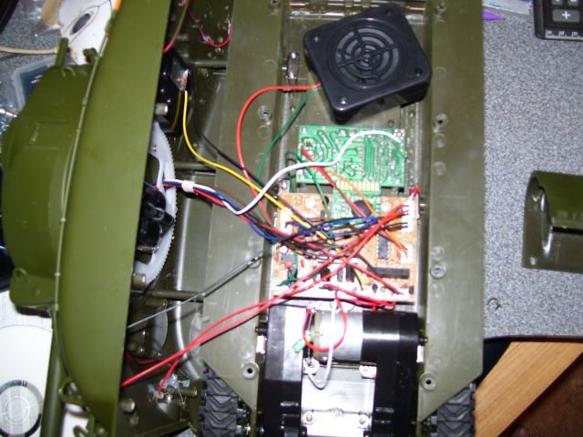

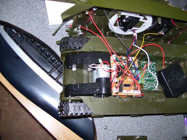

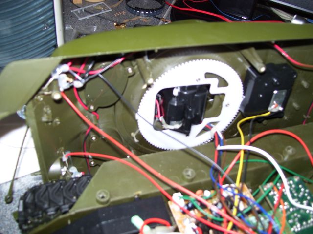

now for the real disapointment the internals same crappy electronics there is no new board just a new addon sound chip same transisters for motors as the old boards plastic gearboxes plastic gears and piss poor mounting of the gearboxes they are mounted with non re enforced tabs on each gearbox very thin and shallow this is an hounest opinion but for a new tank it is very poorly desined and will not hold up to extened use with out major mods and at 163 dollars not worth it

BREL
Posts: 2473
Re: sherman
Post by BREL »
the gear box cover looks a tad too long to me or is it the camera angle
see they have used the same crap electrics then
