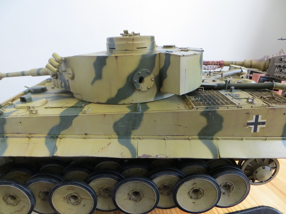

So with oil dot fading it helps if you have a flat wide type brush and very tiny specs of oil paint on the model, put some turps on the brush, wipe almost all of it off then draw the brush down the surface. It's very important to always go in the same direction and try not to have one dot directly above another. The idea is you can barely see the streaks, let it try and take another look. It's also easy to use way to much oil paint, very little is needed, not much more than a large pin heads worth.
I've done it here: download/file.php?id=40935&mode=view
You can just make out some of the darker lines but the green and yellow I used to fade the paint you can hardly see but that washed out, sort of sun bleached look is from oils over Tamiya paint. I've also used it on the wheels a little but the colours are darker mixes.

Great effects billpe might give it a go.

That's about the same effects I get using acrylics Bill, looks really good BTW.
